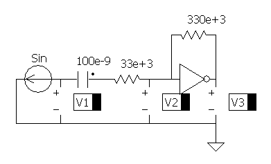

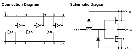

A question for the Gurus :
With the circuit shown below I obtained
the following readings while comparing operation
@ 3.3V, 5.0V, and 12V .....
..........3.30V..........5.00V.........12.0V
V1.......0.13V..........0.14V.........0.18V
V2.......0.02V..........0.04V.........0.06V
V3.......1.00V..........1.00V.........1.00V
Obviously the open loop gain goes down as the voltage increases.
Why ? For some reason I would expect the opposent .....

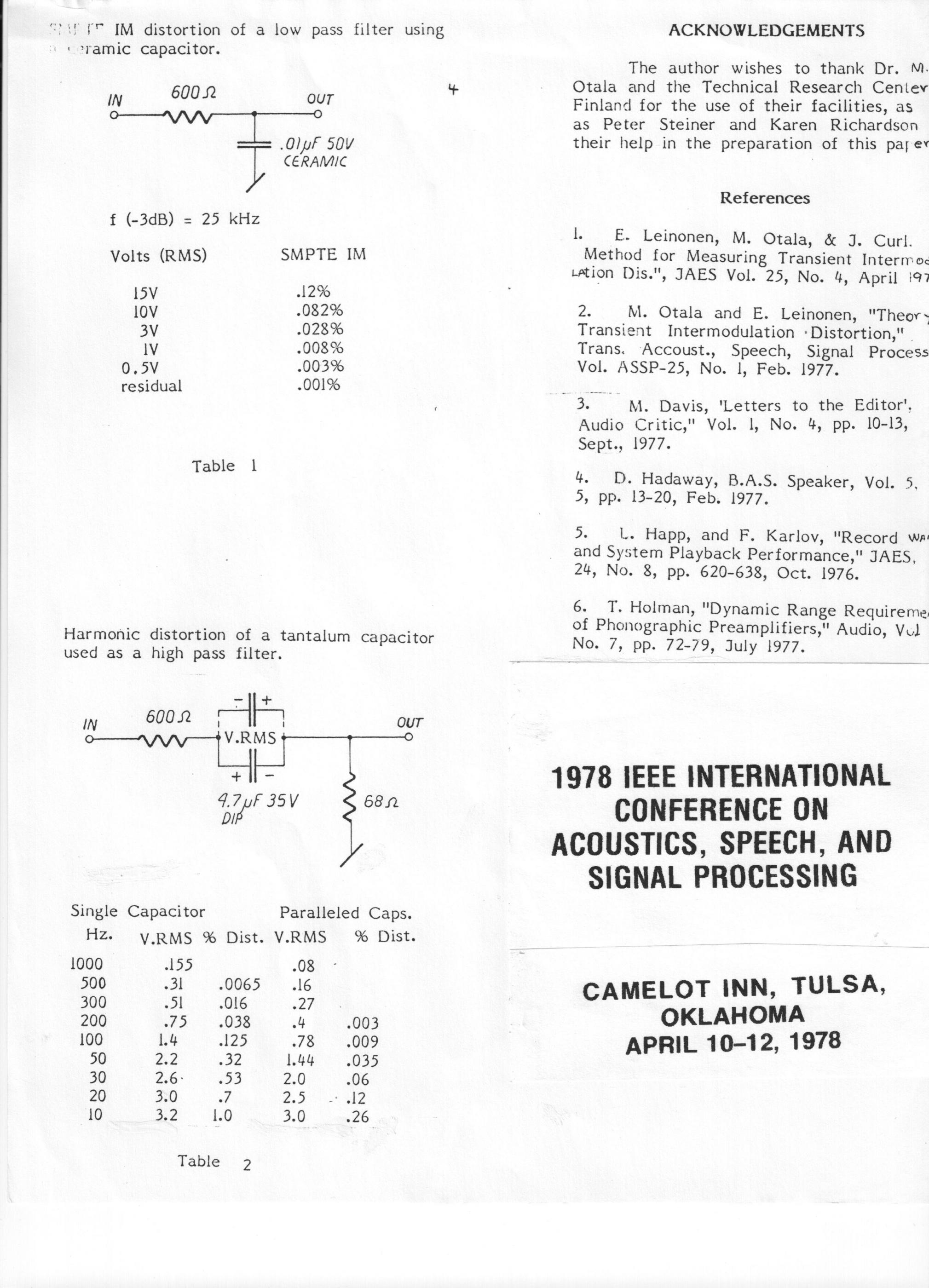

The tests by Bateman and Self etal are for a condition of minimum ac voltage drop across the capacitor. That is a normal condition for coupling caps.
In applications, such as, EQ, RIAA, Filtering, there is a voltage drop across the capacitor and that is another normal condition. When there is a voltage drop across the cap, there will be distortion produced.
The only source of this distortion is from the dielectric material (neglecting construction defects). The material with the lowest distortion has the lowest DA (dielectric absorption).
With polar dielectrics, such as electrolytic and Tantalum, even in coupling applications, they can be heard in some mfr'ed gear. So, I suggested the now popular "DC Servo" circuit. But in other applications where the cap is an important part of the filter/EQ circuit, only better quality dielectrics can be used..... those with lowest DA. This is the basic culmination of knowledge for audio applications I wrote with W.Jung in Audio magazine many decades ago.

In view of John's and Richard's posts above, I feel justified for refusing to use tantalum in an active circuit as a decoupling element.
To be sure, I never went as far as measuring the distorion aided and abetted by tantalum caps, but they simply sounded more oblique to me, with a notable loss of ambient detail. Didn't have the gear I have today, anyway.

Here is what I showed Julian and Ivor back before 1980. They sadly ignored it.
Why sadly? Their products seem do do quite well.
