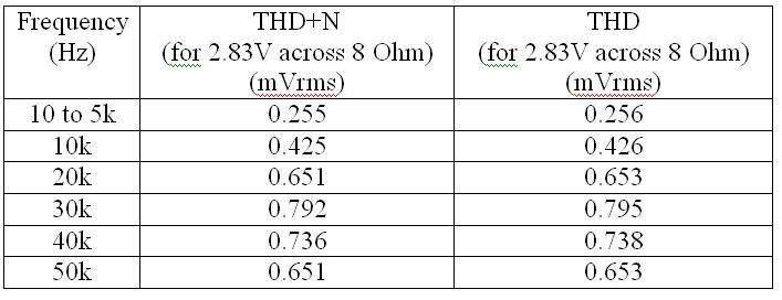

As you can hear 30 db into the noise floor (Depending on how you define noise) saying it can't be measured with the equipment they were using then isn't really informative.
Then there is the issue of what the noise floor is! Op-amps of the day were not exactly quiet.
At the 4th paragraph of Stereophile’s measurements you’ll find this:
Noise (unweighted, ref. 1W into 8 ohms) measured –88dB, either balanced or unbalanced.
That’s 0.113mVrms across an 8 Ohm load. This is unweighted Noise with no input signal.
Measurements of first watt performance are probably more telling.
In the text, they say that the 1 watt residual is noise-dominated. So the crossover song and dance is just a deliberate distraction.
You are right, but only if noise is all the sound there is, that is in a no signal situation.In that case, there will not be any distortion produced.
In case of a signal, we are talking about 1 W output by means of example here, there will be a lot of sound produced, way above the noise floor. It is a nonsense to speak in that case of being able to hear 30dB below the noise floor. With the kind of amplifiers we are discussing here, you won't even be able to hear the noise itself at much lower output levels, let alone that you can hear anything 30 dB below it. Remember the marching band?
Yes, yes, yes.

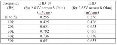

There is Fig.4 (THD+N (%) vs frequency at 2.83V).
Acc to this diagram, for 8Ohm load we get:
http://www.diyaudio.com/forums/attachment.php?attachmentid=431746&stc=1&d=1407353055
Plug in the sensitivity figure of your speakers and think if you can hear the Noise, the THD+N and the THD that this robust PA amplifier produces.

George,
I haven't looked at the circuit, but Crown would use a variable gain circuit rather than a straight potentiometer is some of their amplifiers. So if that is the case for this unit with the volume set for minimum that is actually a bad S/N ratio!
In any case Crown usually specified S/N from full power and it would generally be above 100 db flat or 105 A weighted. Good but not the best.
However the fundamental issue is that it is silly to expect a monster power amplifier to behave the same as a low power type. I would not use it to drive tweeters in a home system. (I have used MA5000s to drive tweeters in a large system. After removing the factory installed protection crossovers with an inductor that saturated at normal levels the system worked well.)

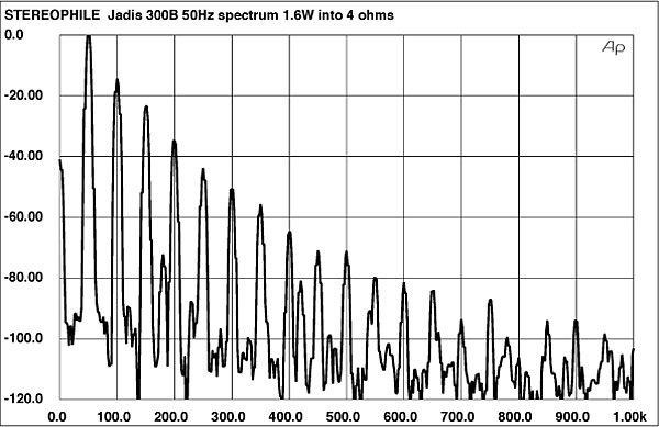

SY,
That is the wrong graph to show why the 300B is so popular. The 300B is a directly heated cathode. It was designed for very long service life and has a very sturdy filament. As a result it has a fairly decent well damped low end mechanical resonance. That really does sweeten up the music.
