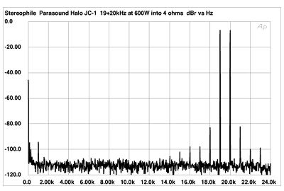

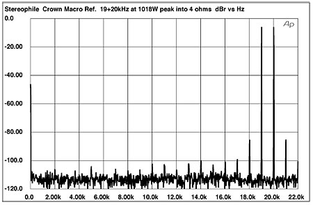

What is the essential difference between these two measurements? Look carefully now. '-)

It's like a snake. no it's like a wall, no it's like a tree, no it's a rope and when you pull it...
it is very easy to get very poor sound quality out of most of the older Crown Audio amplifiers. If you look at the schematic the output stage has current limit protection. As these amplifiers are capable of producing massive amounts of current they run into problems smaller amplifiers do not. Most all consumer and even pro loudspeakers used ferrite or even iron core inductors. These are fine until they saturate with high power at low frequencies. Then they behave like a short circuit. This activates the current limiters and quite simply they squeege (Burst oscillation of varying frequency.) Now if you have a system that can actually handle the power you can hear it quite distinctly. On smaller loudspeakers the actual noise doesn't stand out by itself, things just don't sound as clear. As the ear is relatively insensitive to low frequency noise such as record warp it was not obvious what was degrading the reproduction quality.
...out comes pollution.
Now who cares about distortion measurements at full power? When it is that loud the loudspeakers ain't exactly linear. Show me .1 watt!
That I agree most probably is a major point to sound quality (or lack thereof) with real world speaker loads! And something you won't see in any of the graphs that were shown.
Didn't we agree last century that measurements say squat about sound quality? And now even JC starts comparing IMD graphs!
Confused in Belgium,
Jan
