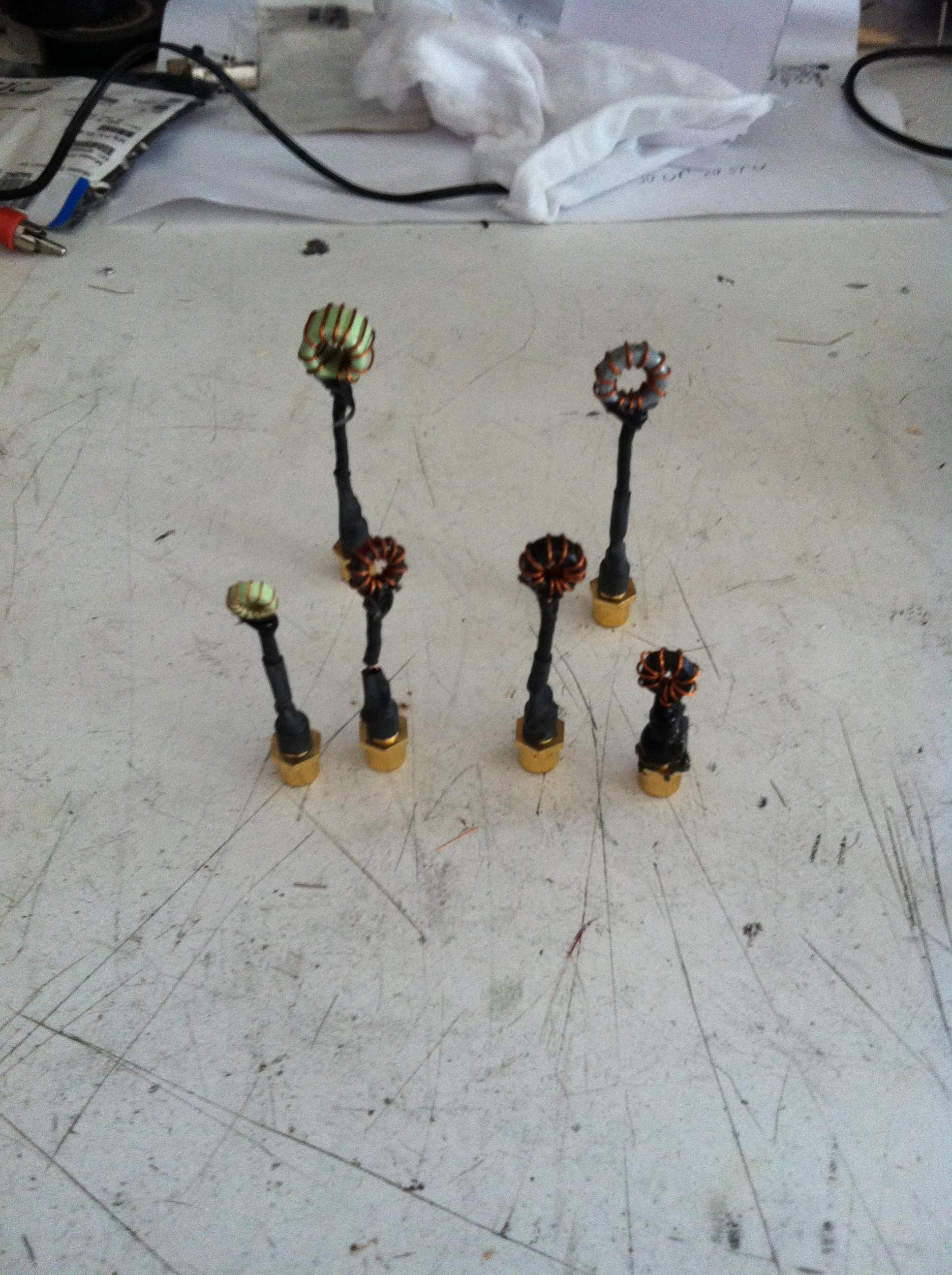

As to distortion measurements on wires. It seems when you have a contact problem it is around -145 or higher! It also changes when you swap directions. These days I am getting decent clean readings down to -160 for special test jigs.
Yes measuring the wire before and after abuse shows changes of 3-5 dB on half a dozen samples. But let's wait and see if anyone else can get similar results.
Can you repeat in simple terms what the test its exactly? I'm thoroughly confused by issues of level, current, where its being measured etc. You also mentioned measuring -160 dB distortion product. Is that ref the peak level of the two IM sources (I think that's where this started). I can measure -160 dB harmonics of a 10 KHz signal but IM is a different story. That level is very close to what seems to be achievable performance with the best technology today.
I would like to know source frequencies, levels, and impedance. Load impedance. Is there a passive prefilter to eliminate part of the HF component? Are the wires balanced or is one grounded? If the signs are promising I'll give it a try. I would start with wirewrap wire unless the silver plating will invalidate the test.

There are two tests. Based on the article you posted about PIM and the bits here at the time I tried taking 10' of magnet wire twisting it and measuring it for 19/20 kHz IM on my AP source 50 ohms and whatever (10K?) for the load. This was at a level of 10 mV. using it as a balanced cable via the xlr connectors. Looking around 1K not surprisingly there was a baseline of distortion. I then over twisted the cable back and forth 5 or more times. I also wiggled it a bit. I then remeasured the cable and saw a bit more distortion.
Now I also have the device I originally showed in AX 9/11 (I think) that was originally designed to try and see solder joint distortion. I have since improved it a bit. Adding some aluminum shielding and upgrading the quality of some parts as I have learned a bit since then.
The original used a pair of transverse oscillators and these are now followed by Wein resonators feeding 600 ohm resistors that go to a 10 ohm resistor to signal reference ground. The junction feeds the cable under test. A low noise differential amplifier (Noise around 700 pv/sqrt(Hz)) provides 30 db of gain and low pass filtering. As the test signals are just above 90 kHz and the residual is 2.25 Khz it is reasonably easy to get the fundamentals below where they would be a problem for the FFT analyzer. After the analyzer output I feed a few more filters centered around 2.25 khz and this then feeds a dBx log response detector to produce a voltage for a 50 uA panel meter.
The whole unit is fed by four 12 volt batteries two for transmit and two for receive. The preamp has on board cap multipliers for each stage.
I also use at least 1024 averages to reduce the noise a bit. (As my device has decently random noise the dither effect seems to work.)
