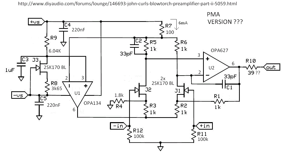

Isn't the amp inverting, R6 contributing to the gain/phase since it's in the feedback loop? R1 defines the lowest closed loop gain at which the amp should be stable (that would be with the input open).
I think Fig.8 shows the amplifier block including feedback G =~-38. The external network is a divider of ~38 tuned by the pot to give a null and show only the error. This only works well with a phase correction. In their figure the amp and input source are low impedance so by reduction there is only 1 time constant 470||(470 + pot + 39K) and 680pF which is added to the 150ns. See Bob Cordell's distortion magnifier.

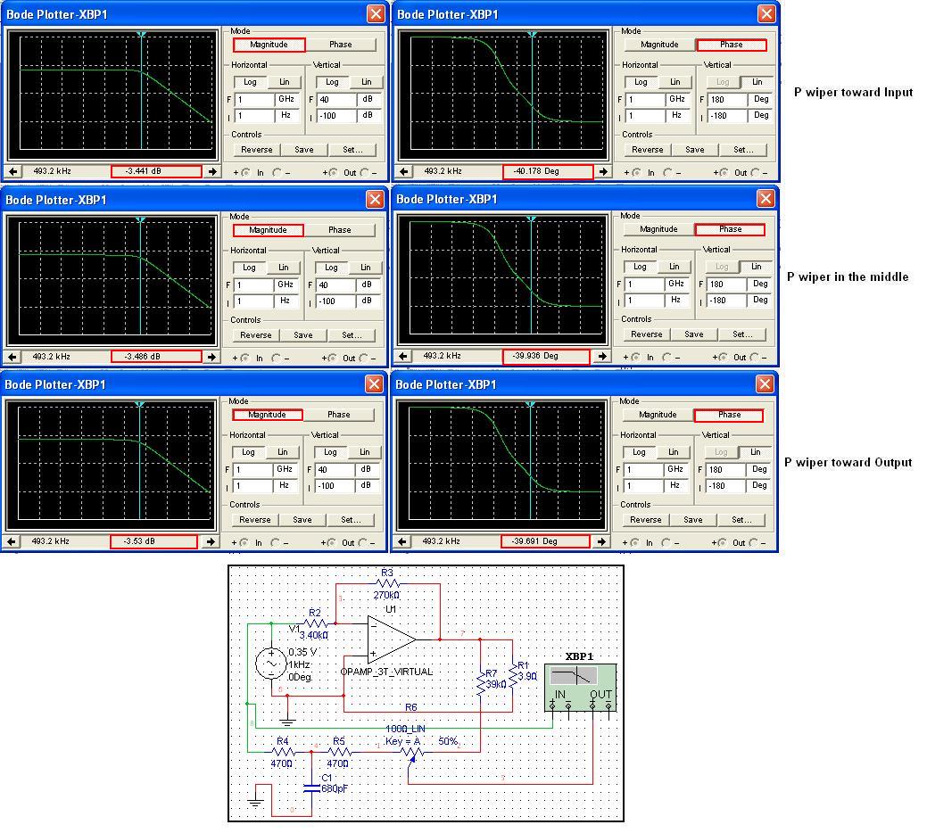

Question - the 470 Ohms and 680 pF is at 500kHz, how does R2 contribute to the phase when it is in series with 39K to the output?
Good point Scott
I tried to see the effect of the pot. Whether G is –38 or –32, the pot max effect is 0.09dB and 0.5Deg at 500kHz 😕
