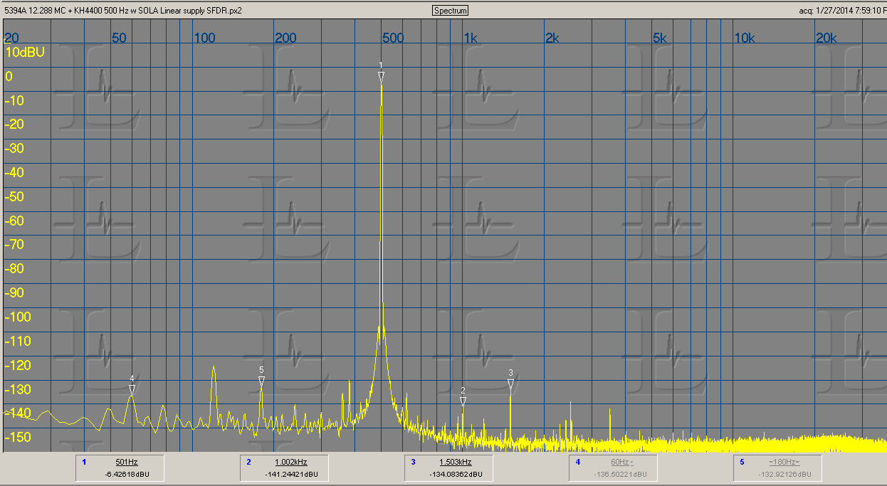

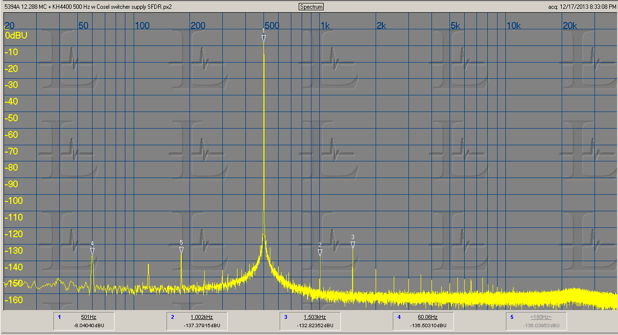

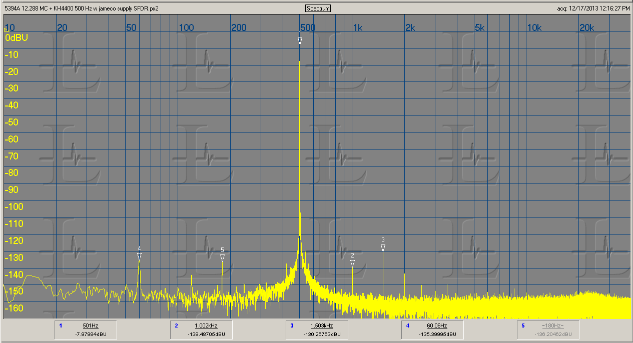

Here, for reference, are distortion plots of an ADC using three different supplies. The first is a Jameco linear supply kit. Its pretty crude and has more ripple than an regulates supply should. The second is a packaged Sola linear supply and finally a little Cosel switching supply. The opamps on the ADC board (AKD5394A) have no local regulation and only nominal local filtering. I was very careful with the grounding. The source has some hum in its output from leakage and supply ripple.
The conditions were not identical but similar and the plots will have different averages etc. so don't read the differences as due to the power supplies alone.
I could find no reason not to use the little switchers in this application even with such a stringent THD+N capability.
