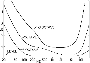

What exactly is leftover when you subtract "most differences" from all differences?
Clark's frequency response threshold curves?
clearly people can make relatively fine distinctions that are statistically significant in ABX tests - and the consequence is that anyone wanting to claim audible differences without matching to these levels is open to the obvious criticism that the level differences were the only "real" difference in a "relaxed" subjective test that didn't control for this
from: ABX Amplitude vs. Frequency Matching Criteria
