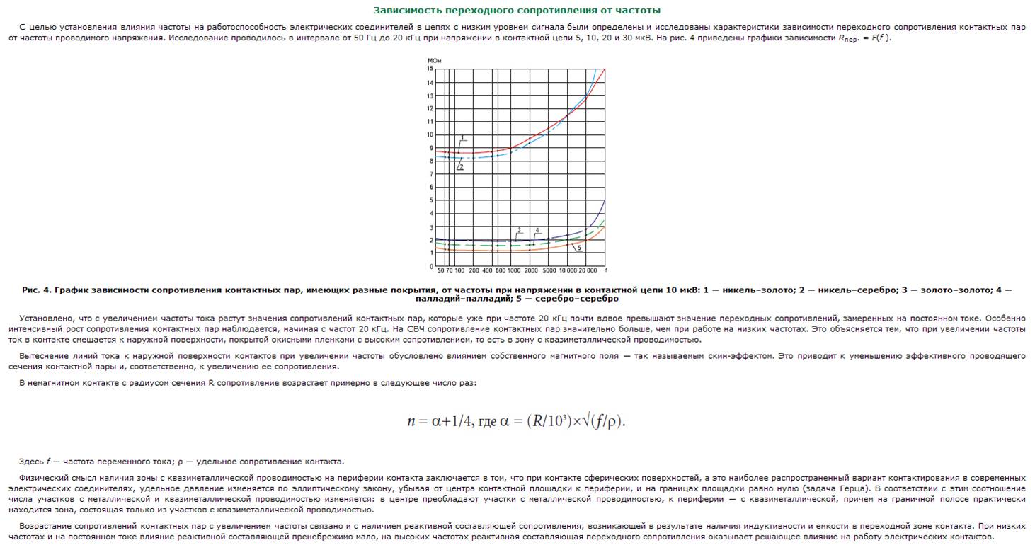

I've found relevant paper, in russian, published in
L.Safonov, A.Safonov "Technologies in Electronic Industry", No2, 2009
Ïðÿìîóãîëüíûå ýëåêòðè÷åñêèå ñîåäèíèòåëè. Ðàáîòà ýëåêòðè÷åñêèõ ñîåäèíèòåëåé â öåïÿõ ñ ìèêðîòîêàìè è ìèêðîíàïðÿæåíèÿìè
What is clear from the paper, that many contact issues appear in uA and sub-mV range, non-conductive films of 10-100 angstroms grow and are destroyed by currents. For signals above 1V we usually do not have problems becuase of fritting, growing dielectric films are destroyed by discharges. However, below 50mV fritting becomes impossible and contact becomes unstable.
There is also frequency effect (picture eclosed), for 10uV AC signals of various frquencies contact resistance varies with frequency, rising sharply at 20kHz. This is because current density increases in near-surface non-metallic (quasi-conductive) region.
