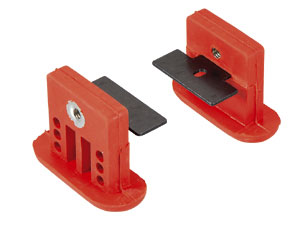

Neoprene vibration grommets cost less than a dime each (though Digikey charges $1). One on each side of a mounting hole means ~3 quarters to soft-mount a board, and no need to drill larger holes.
Less than 50 cents each (got a few hundred of these

Jacco, do you have the Part Nr.'s of the red ones? Thanks!Neoprene vibration grommets cost less than a dime each (though Digikey charges $1). One on each side of a mounting hole means ~3 quarters to soft-mount a board, and no need to drill larger holes.
Less than 50 cents each (got a few hundred of these) =>

Don't see any. Did you buy their whole stock? 😀NOS, Pollin in Germany, Nr 40681
