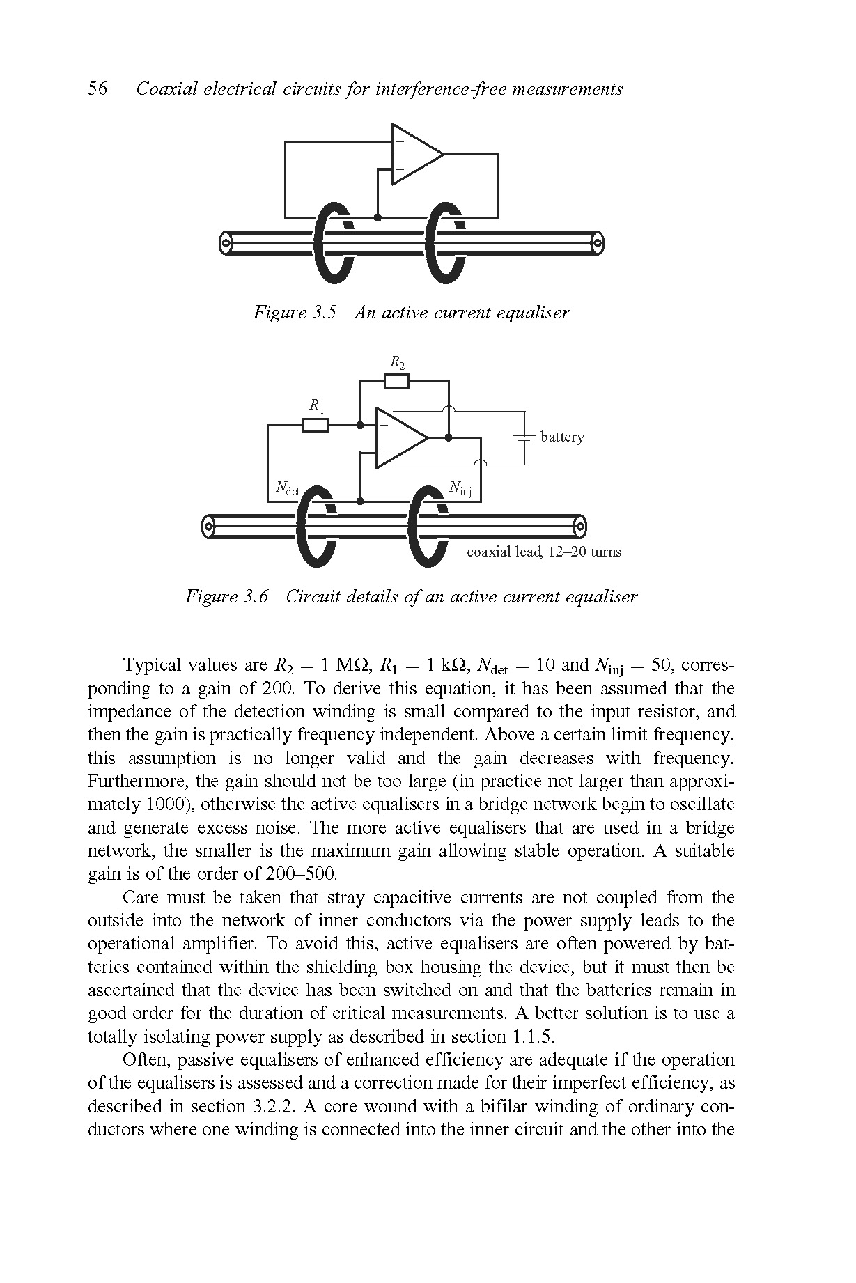

I devised a technique to kill ground loop currents back in 2008, never did anything about it...(In fact, the bulk of it is in my gallery, the drawing with the magnetic core driving the loop with a toroidal pickup between amp and pre. Use the pickup to drive the core inverted to zero the loop current.)
George provided me a copy of Coaxial Electrical Circuits for Interference-Free Measurements, Shakil Awan, Bryan Kibble, and Jurgen Schurr, IET, 2010
Here is a copy of page 56:
Anybody game to try this on an unbalanced coax input to an audio amplifier? It's auto-ground loop busting without breaking the conductivity of the loop.
Perhaps a group engineering/build?
Edit: Oh, btw, it needs to have a bandwidth of 20Khz at least...
