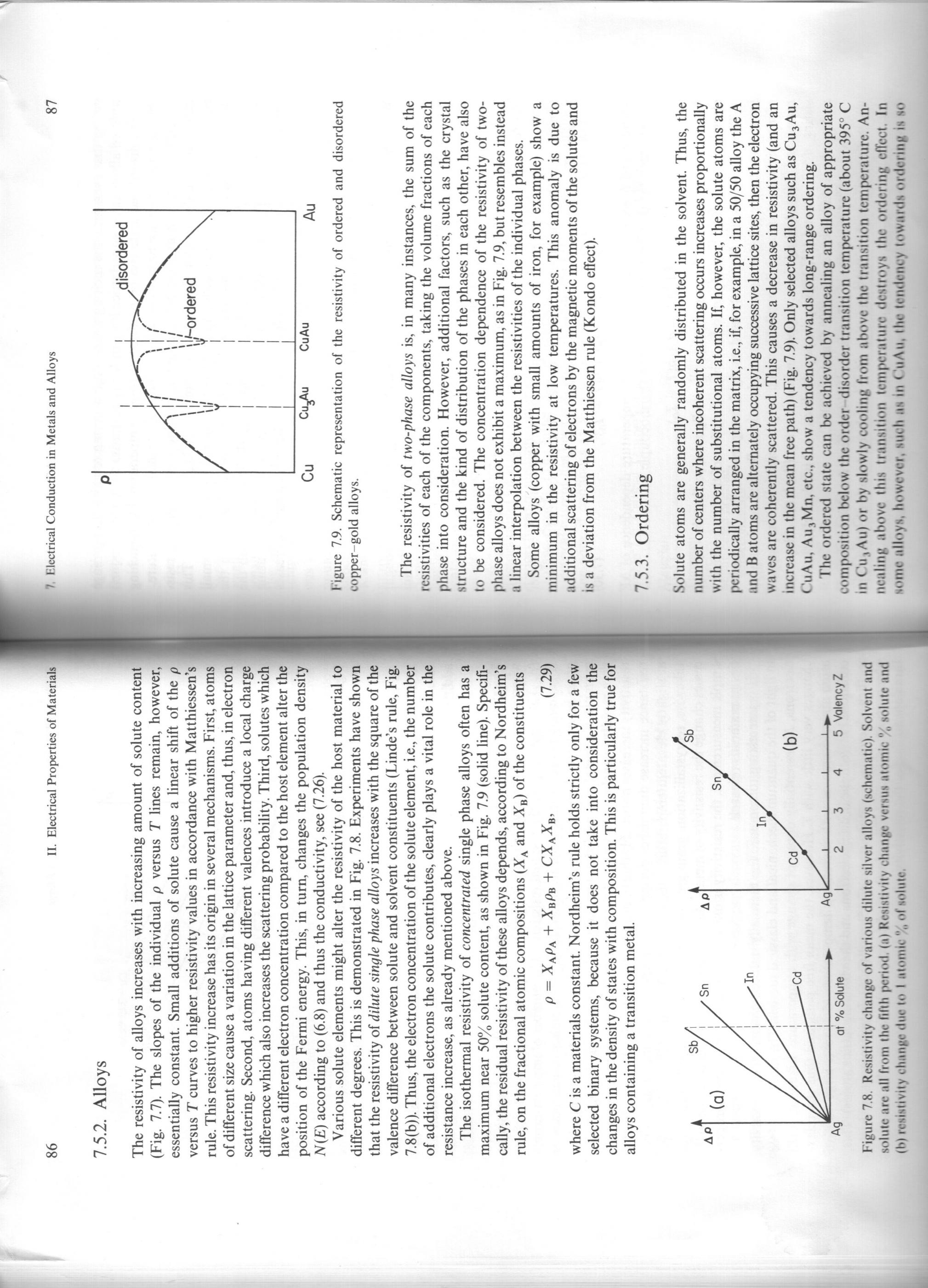

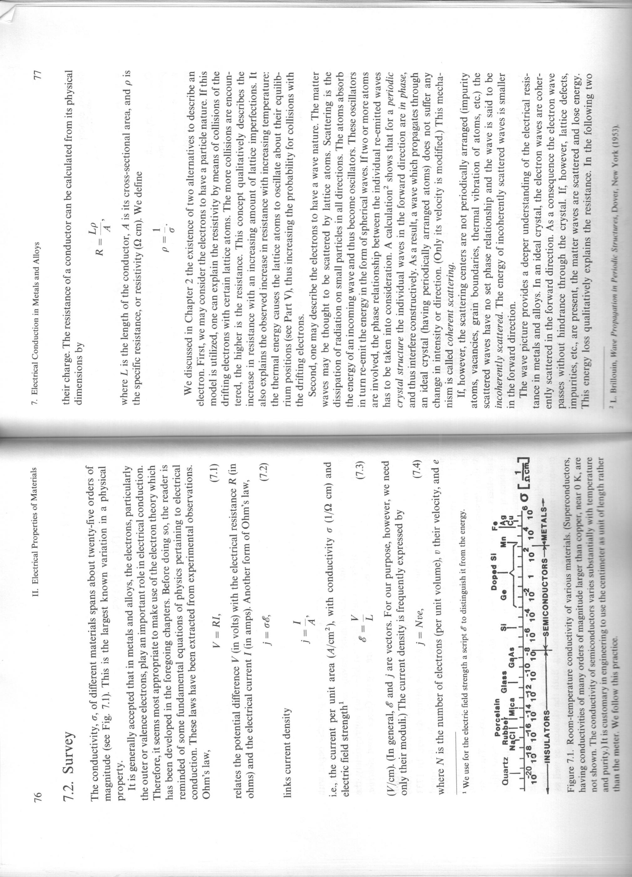

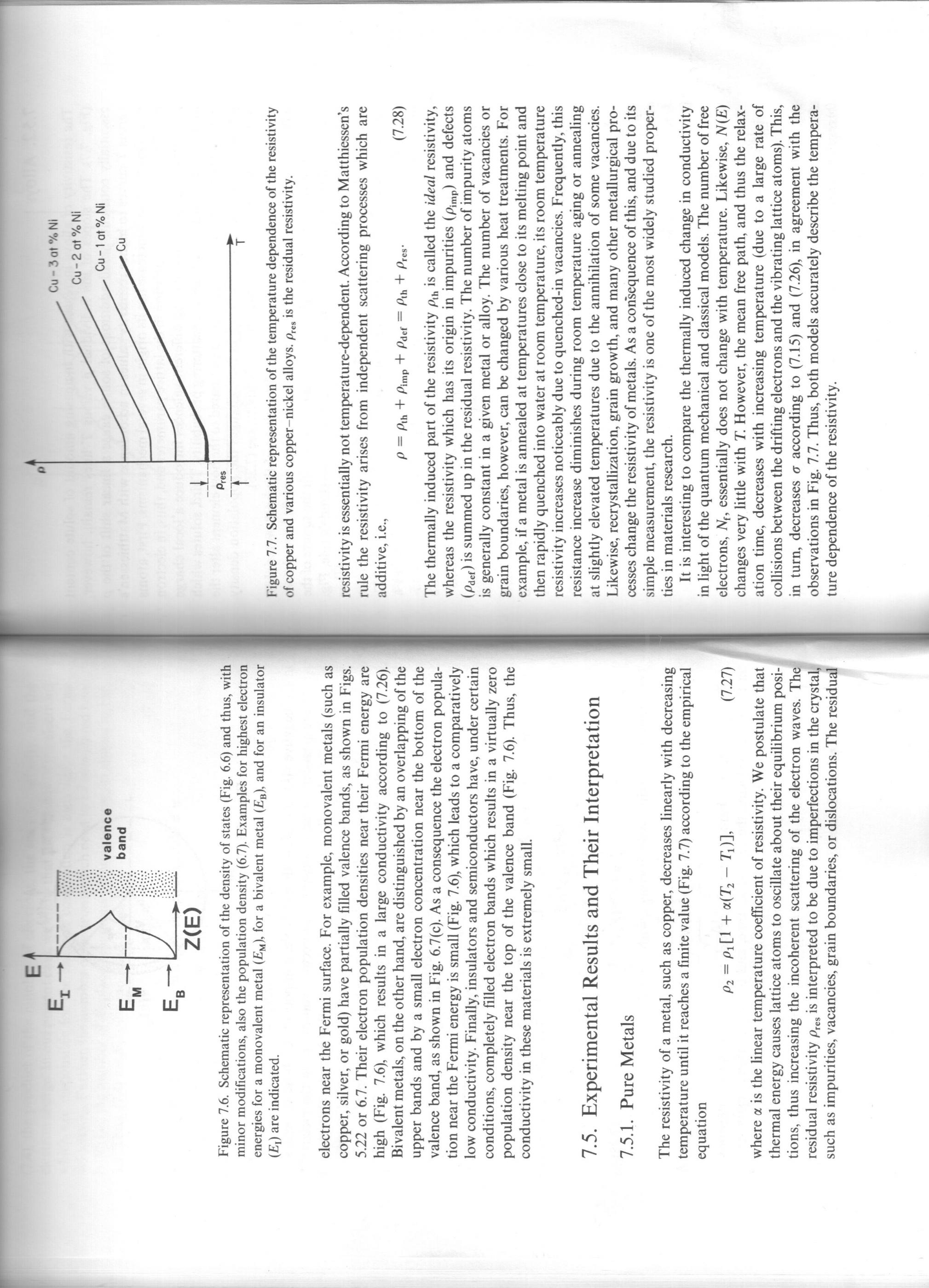

OK, this is the book that I work from when it comes to properties of copper and other materials. This is about the resistivity of copper, AND WHAT EFFECTS IT:
Lattice dislocations ALSO effect it, which is why work hardened copper has lower conductivity than annealed copper. The annealing process allows the copper to re-crystallize, removing the lattice dislocations caused by work hardening.
And as for impurities, they're talking about impurities in solution. Regular old ETP copper uses oxygen scavenging to remove impurities from solution, increasing it's conductivity. In other words, ETP copper can have the same conductivity as an oxygen free copper with a higher inherent purity. So it's a waste of money chasing the 9s. All those 9s look impressive for marketing purposes, but that's about it.
