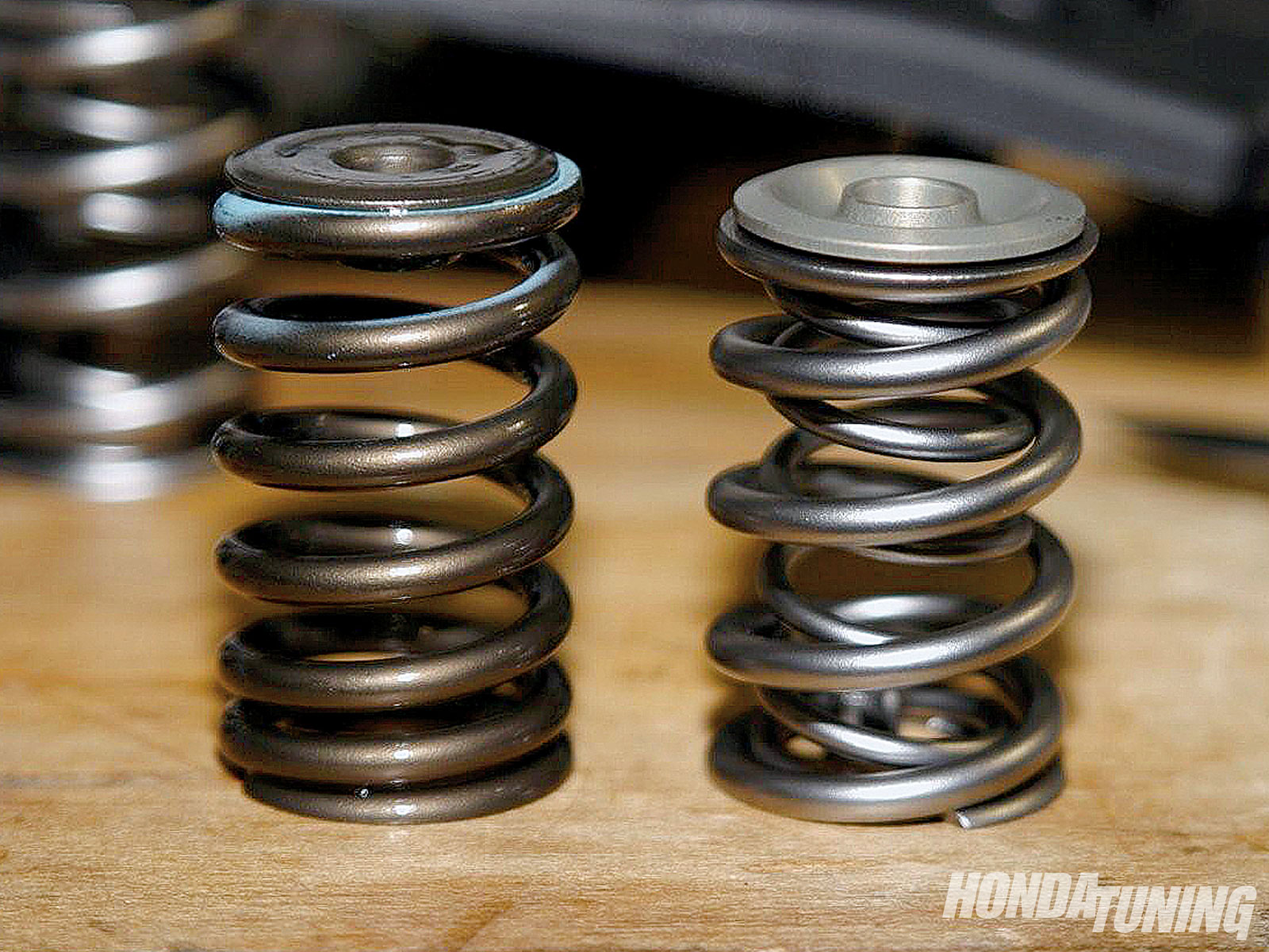

Or these for free.....
A webbing of cured standard roofing/bathroom silicone between the coils damps them.
A heavy slab (an offcut of standard kitchen top granite/marble etc) suspended on springs makes for a very cost effective equipment platform (zero cost !).
Placing another slab on top of line level gear makes for a very high mass assembly that is nicely inert.
Mileage may vary according to donor car.

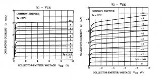

Typical "complementary" NPN/PNP
I just grabbed a couple of graphs for some Toshiba devices sold as complements of eachother. This result is typical of many if not most, Beta/Va quite different as well as saturation characteristics. Absolute Vbe's also all over the place. You can match beta's at one Vce that's about it.
