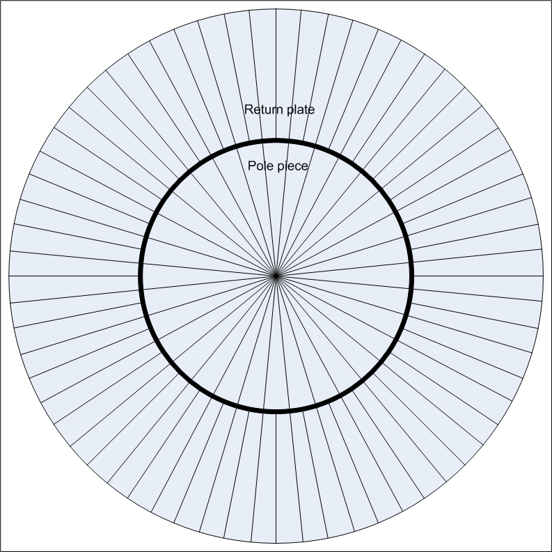

So if I am following you correctly are you saying to place a layer of thin copper lets say at the junction of a top plate and a steel cup to break the steel circuit at some point outside of the gap where a normal shorting ring would be placed? I know what an edm machine is so you are talking about a thin electrode wire I think? Could this be a few thousandths of say copper shim material? Would this still have the intended effect of a Faraday ring in reducing eddy currents?

A pic:
EDM the pole and plate like the picture. The flux has to travel into the surfaces at the gap, and there are no cuts which introduce permeability of 1 into the mix. The cuts eliminate eddy currents.
Any structure which the flux has to pass through cannot have low permeability. Making the plate or pole out of steel laminations introduces material in the 2 to 3% by volume range, and that 2 or 3 % air or glue heavily compromises the permeability. Lam stacks are anisotropic, permeability normal to the glue surfaces is not 98% of the iron, but easily an order of magnitude down at the least.
This design cuts the eddies, and retains the flux path reluctance where it was supposed to be.
Edit: I doubled the cuts on the outer plate, but really, all you need to do is get the uncut widths at the gap into the 1mm or .5mm range. I've measured stacks with both, and at .5mm, I get very good hf results.

Shorting rings should not be seen by the voice coil assembly.
edit: I added this to my gallery.
Edit v2..Lamination of circles to make the pole piece causes the vc magnetic permeability to cog, so it is unwise to make the pieces out of a lam stack. As the vc moves, the direction it moves must have a smooth magnetic environment.
Edit v3: btw, it is a trivial process to cut everything in the magnetic structure, then vacuum impregnate the structure to hold the pieces together.

Running out but will reply later, that looks like it would be very difficult to produce those wedge shaped sections?
No. Trivially easy.
1. Bond the entire magnetic structure.
2. Bond the entire structure to a carrier surface, front of gap at top.
3. EDM horizontally through the center of the pole, down to the carrier surface.
4. Rotate some increment.
5. Repeat cut down to carrier.
After all the cuts are done, each wedge is held in place by the carrier.
While still bonded to the carrier, vacuum impregnate the entire structure. If you want, fill the gap with a material that can be removed at a later date, teflon, or something that will dissolve or melt. Just do not exceed curie.
Or alternatively, don't fill the gap, simply clean it out post processing.
Vacuum impregnation is not that difficult, and if the gaps are 3 to 4 mils, just select an epoxy that has a low viscosity and reasonable pot life. Cycle the vacuum several times, and cure it at atmospheric.
Just de-air it properly first. Remember, you are relying on the impregnation for structural, not for magnetic reasons. It doesn't even matter if you get bubbles, even out to 10-20%. But a good process will get you void free.
You can even put features on the pole and outer plate to aid in placement during impregnation if you don't have a good enough process for bonding to the carrier.
This can even be made as lots of thin wedges that are assembled using a thin paper or glasscloth shim between metal surfaces, with fixturing to hold it concentric to some tolerance. Choose the paper or cloth for a specific thickness, and as long as it's porous, good deal.
Don't go for a matched expansion epoxy, as the filler will make it very difficult to get the epoxy into the gaps. It tends to clump on the ends of the gaps and at the edge of glasscloth. Only use totally unfilled epoxy.

Thanks JN for the detailed description. That sounds interesting but sure would be cost prohibitive on a production basis. You said someone has a patent on this methodology? Basically it sounds like a laminated transformer concept with high permeability material such as a stainless steel material.
