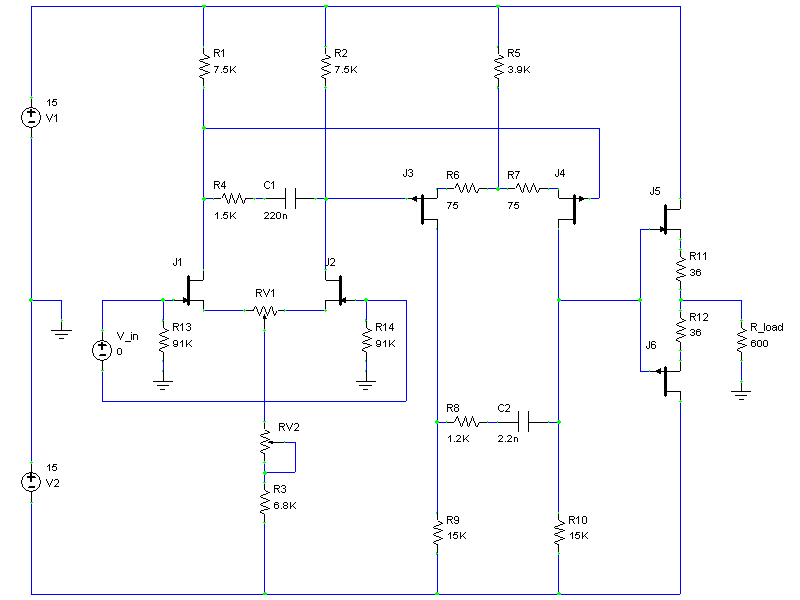

How about this circuit ?

Patrick, this circuit is very nice. A little too simple, so there will be some easily measurable distortion, but more advanced than 90% of everything out there.
The question is whether those measurable distortion (mostly low order) is important ...
Of course it is easy enough to make it balanced and hence cancels out even order distortions.

Patrick, is this your design? If so, have you made it available on this website? It is a DARN good design. Most potential problems have been eliminated.
No it is Mr Evil's design, but I liked it a lot and did build a balanced version, some time ago.

is actually already fully balanced. We just need to add another JFET follower at the drain of J3.
In the one I built a few years ago, but I was too greedy and wanted 80dB gain in two stages (for MC). I also paralled 4 pairs for K170GR for the input stage, and ended up with too way much DC drift (volts). I did not add the servo right and ended up with instability.
But I think the drift can be brought under control by thermally coupling all JFETs, and also by reducing gain to 20 or 30dB per stage.

Of course it does not have the elegance of your complementary JFET input stage. But this is a very good circuit IMHO for its simplicity.
But maybe you would give us some pointers how to improve it futher ....

It is not the offset itself, because you can trim that, but the changes of offset with time that was causing the problem. I am pretty sure it was poor implementation on my side, and that thermal coupling all JFETs will make significant improvement.
Maybe I should have used K389/J109's instead.

Looking at the offset problem with Evil's design is for a different reason than I might have. One problem is that there is no real reference to ground within the circuit. You can set it to 0, once, but any temperature or supply voltages will upset the setting. It is really a common mode offset, because it could be balanced out with an ideal transformer added to the output of the balanced version. With single ended, you would see it as just offset. That is why I use 2 different servos, one for differential offset, and one for common mode offset. I was fairly successful, without any initial adjustments, because I have a ground reference at the output, and the complementary design tends to track with temperature differences.
