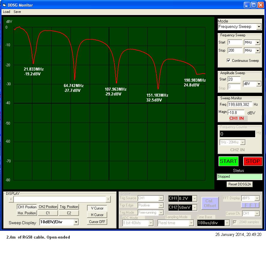

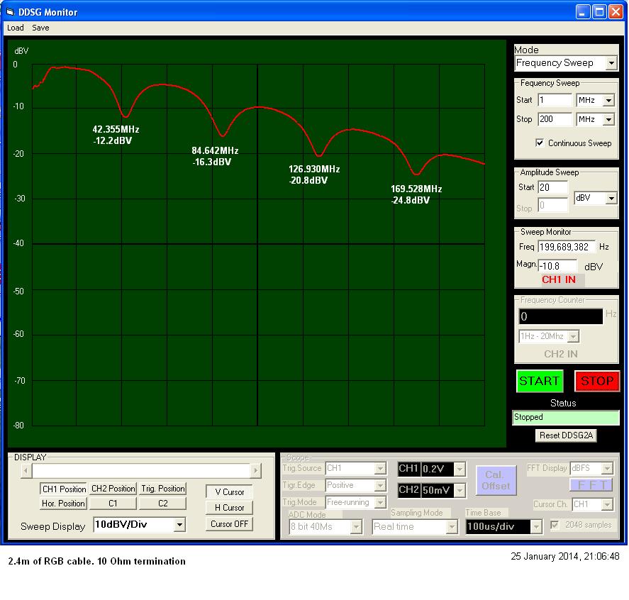

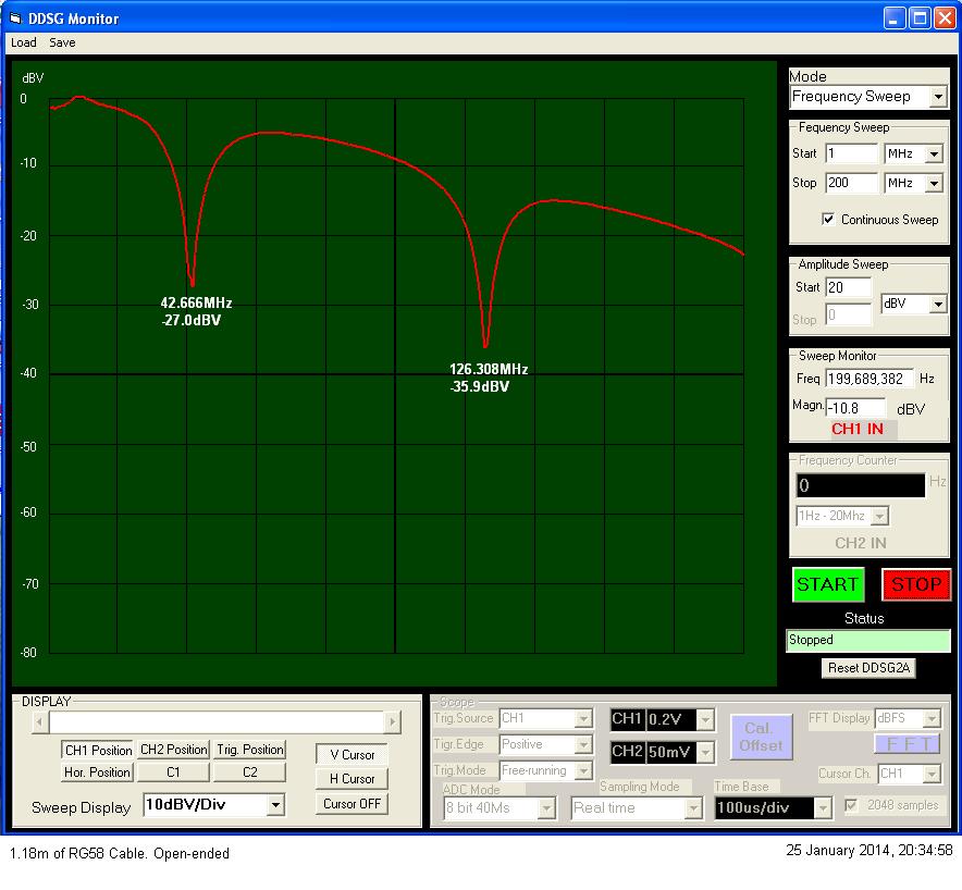

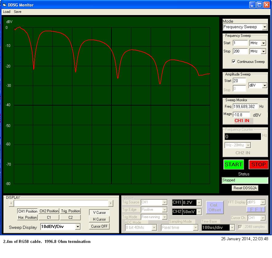

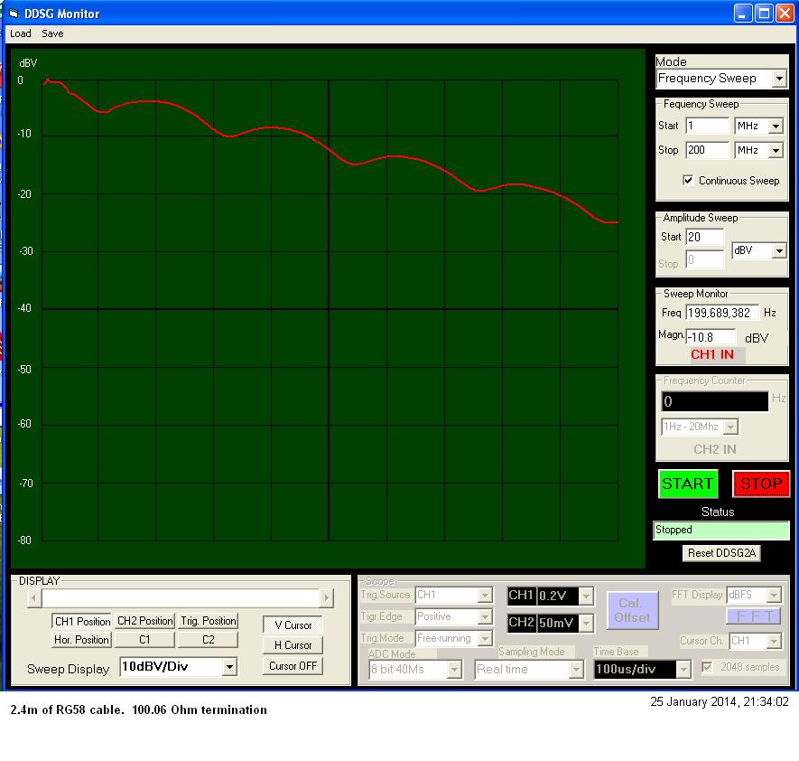

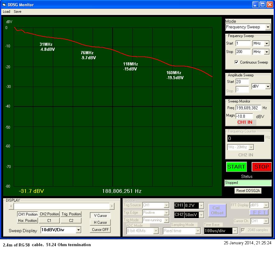

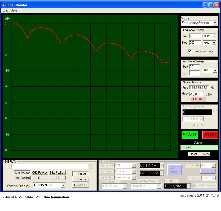

This is with coaxial RG58 cable.
See the resonances as seen at generator-out due to reflections at the cable end and the effect of resistive termination at cable end.
Generator's nominal Output impedance 50 Ohm
George, try to put a divider like 50/5 ohm to the generator output. Then you will drive the cable from <5 ohm impedance. You will get gross impedance mismatch. Then the effect of the terminating resistor will be even much more pronounced.
True PMA, some high end stuff I respect and like, but some leaves me wondering where the money goes. My main despair is with some of the mid range stuff, but that is becoming the norm with a lot of electronics, people want fashion items at a low price and bin them in a year when the next bigger better model comes out. We work on both ends of the spectrum, designs where quality comes first and cost to an extent is secondary, and designs where we have to cut every last penny off a design.
Yep. Correct.George, try to put a divider like 50/5 ohm to the generator output. Then you will drive the cable from <5 ohm impedance. You will get gross impedance mismatch. Then the effect of the terminating resistor will be even much more pronounced.
I’ve done it as I am working on the issue.
Jn has put me on fire and I am in the preliminary steps.
I will start a thread, I will post a link when I am ready.
Thanks again.
George
>Edit:The pics above is just to show the effect of termination and the shifting down in freq of the resonances as the length of the cable increases
