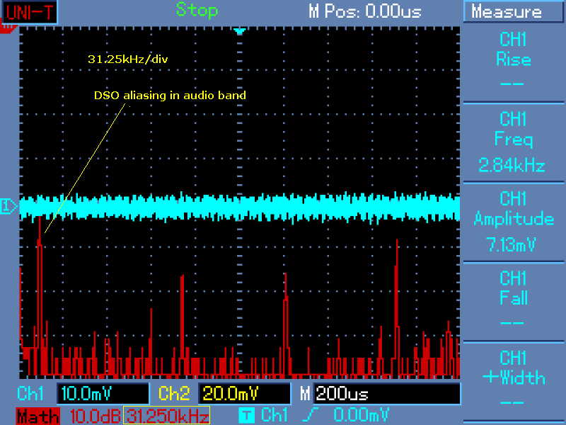

Pavel, have you noticed with older DSOs aliasing effects, showing on the screen signals of much lower frequency (and unstable amplitude) than the real input?
Hi George,
this is a shot on the target!!
Yes, I have noticed the same problem. With DSO analysis, I have "measured" quite high spectral line below 15kHz when analyzing voltage on long link cable with AM radio RFI pickup. I could not believe my eyes so I used an audio band FFT system with 48kHz BW. No spectral line in audio band then! And much higher dynamic range of the audio band analyzer, more than 130dB, compared to 60-70 dB of the DSO. The DSO "measured" a spectral line below 15kHz with amplitude of some -40dBr. It was nothing but aliasing error, lack of input anti-aliasing filter.
Pavel
Thank you for the confirmation.
I asked because I have noticed it in the past and I am cautious ever since.
I think that these investigators may have the same problem:
RF noise picked up by the created test loop, which shows as signal below 100kHz due to aliasing at their DSO.

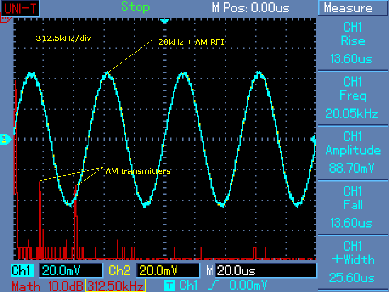

George, I have succeeded to dig out some of my older measurements of RFI pickup. The plot at 312.5kHz/div is correct and shows spectral lines of local AM transmitters. However, the second plot in 31.25kHz/div is wrong and audio analyzer FFT showed no lines in audio band. One might suggest 15.625kHz of TV row frequency, but it was not the case (verified by another instrument). The DSO line was close to 14kHz and it was an aliasing error. Probably the other lines in that plot were wrong as well.
In my experience, it is often problem when the author of the paper is not experienced in measurements as well and if someone else is performing the measurements. There is a temptation to find out sensational conclusions where they are not and it is very easy to make a mistake or to misinterpret plots.

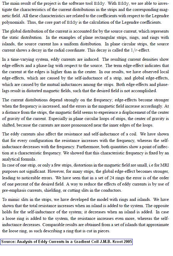

This is for you, regarding foil inductors ect (your beloved in depth analysis & simulation of e.c.):
http://alexandria.tue.nl/extra2/200511789.pdf
George

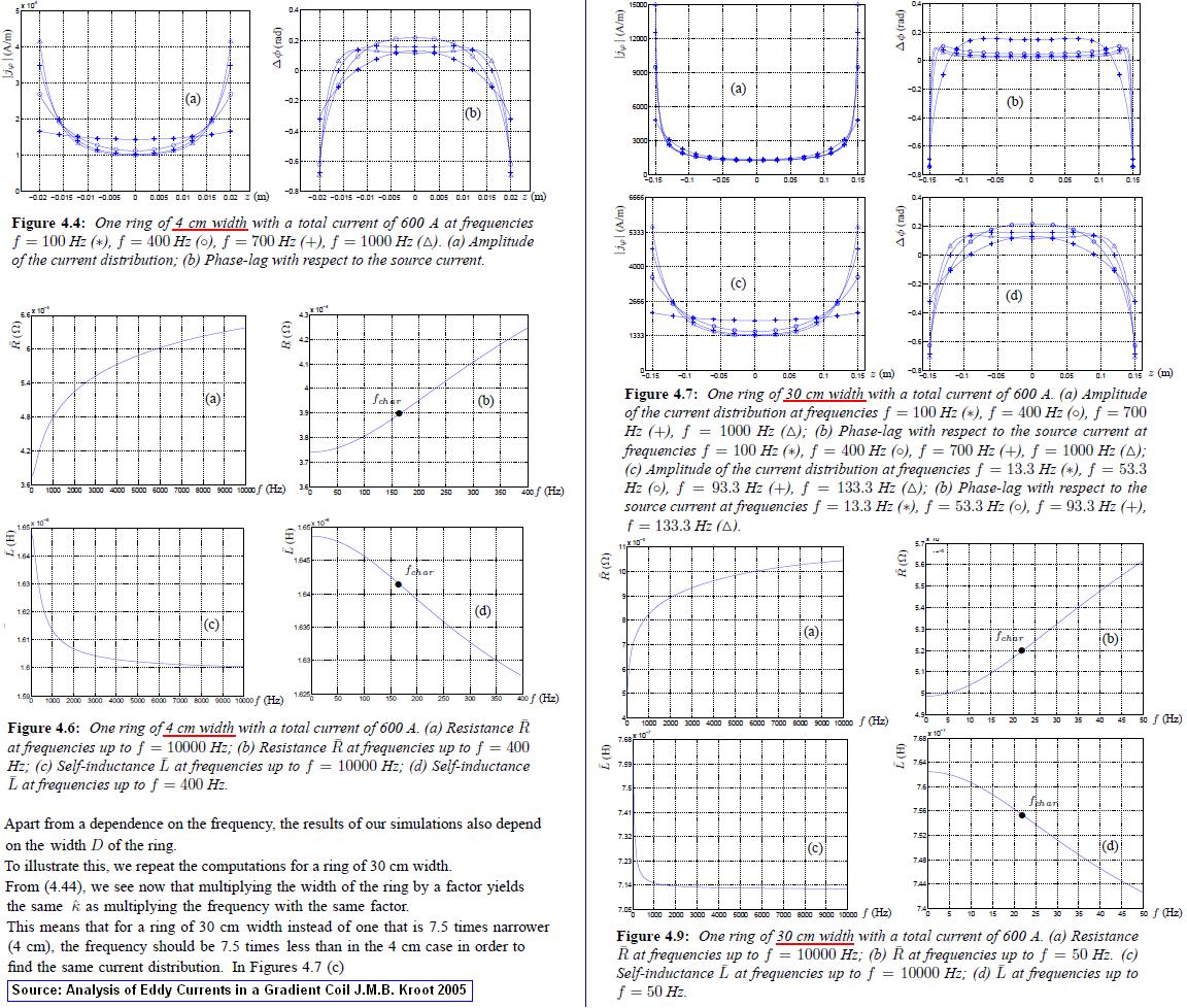

Nice. About 15 years ago I made superconducting gradient coils for the 4 tesla MRI here. It was fun at that time to learn all about MRI's. The issue I also had to deal with was the fact that I made the coils using superconductors, so the surface conductivity which causes eddies is somewhat "high".. The copper outer shell of the supers also increases conductivity about two orders of magnitude at 4.5 kelvin. The wire I used was a 6 around 1 cable, so it also limited my high speed (frequency) operation to 6/7ths of the cable's capacity, as skinning keeps the current constrained to the outer 6 wires when I slew it fast. The inner conductor will not carry current until the slew rate drops below about half an ampere per second. If the wire is capable of 1400 amperes dc, I can ramp it to 1200 amps in a quarter second, supply voltage limited.....the last 200 amperes requires 400 additional seconds.
If you go to page 9, in a nutshell: I hilited in red the salient part.
Quote:
Eddy currents cause undesirable disturbances in the gradient field. Moreover, the presence of eddy currents will increase the resistance of the coil, resulting in a higher energy dissipation. Meanwhile, the self-inductance will decrease, resulting in the need for a smaller voltage supply
End quote
When considering an inductor, the actual terminal voltage is from the equation:
V = LdI/dt + IdL/dt + IR
We are all familiar with LdI/dt and IR, but IdL/dt is typically neglected, as is the eddy dissipation portion of R.
The lenz effect means that a conductive object will try to reduce the inductance of the system by rejection of the time varying magnetic field. That is evident in the L vs F scans I put in my gallery.
The eddy dissipation is proportional to the absolute rate of change of the magnetic field.
edit: Unfortunately, it appears that his software doesn't give us the terms we need for modelling the resistance and inductance vs time. Again, this is how the switchmode guys deal with it as well. Neither are interested in the harmonic distortions, just the dissipations.
