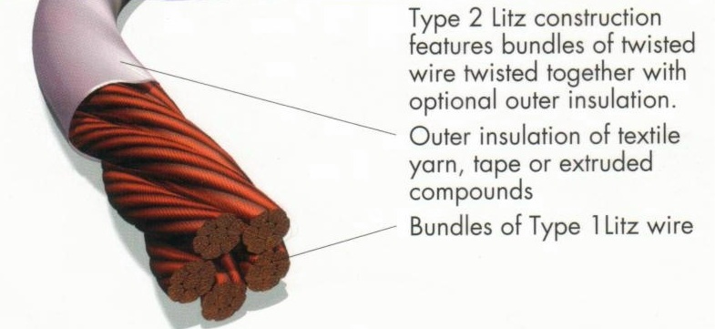

A simple rope lay is hardly "exotic."

Its also not Litz. Litzendraht or Litz wire is woven in a way that all the strands have an equal amount of length at the surface as in the center of the bundle. Rope lay will have conductors that will not ever get to the surface. Also rope lay does not indicate or imply insulated stranding, another key element (but not the only one) of Litz wire.

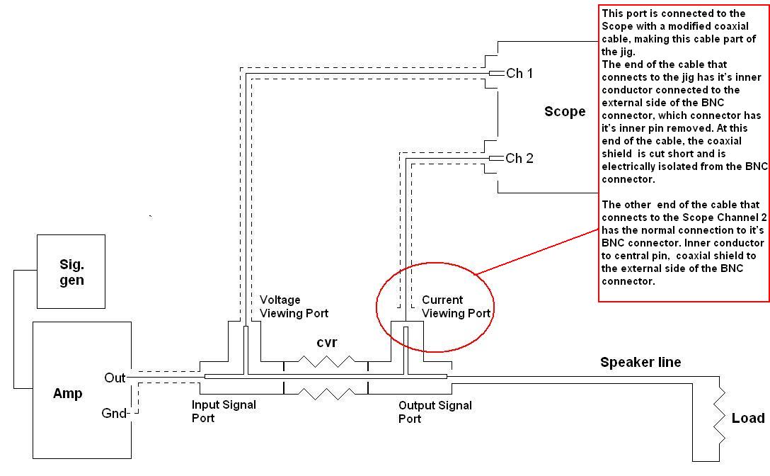

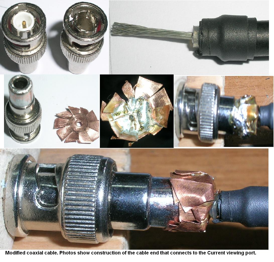

One question. The scope ground to ground, are they connected? If so, the scope frame will short the resistor.

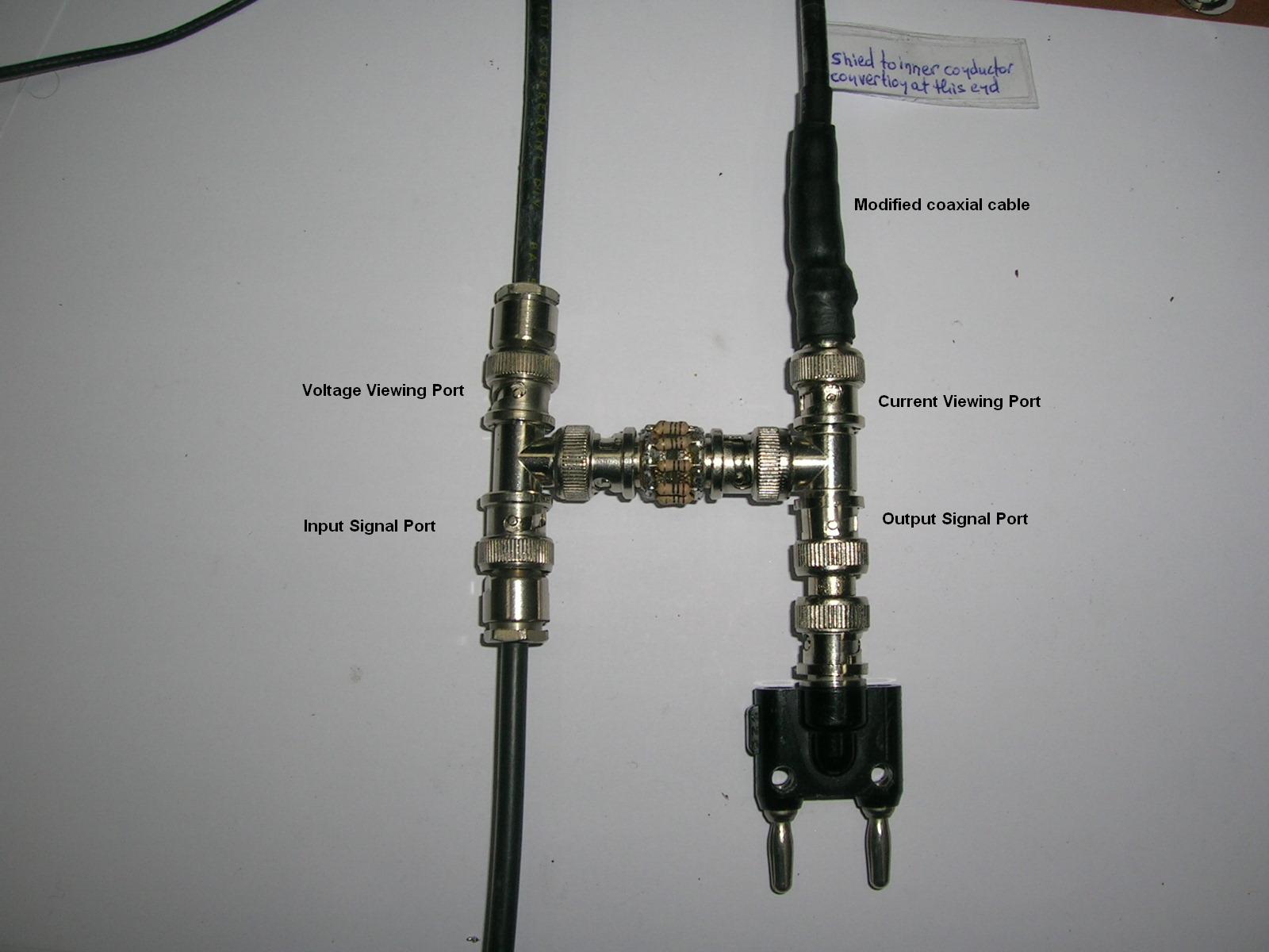

That was one of the difficulties.🙂 See the first two attachments.

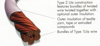

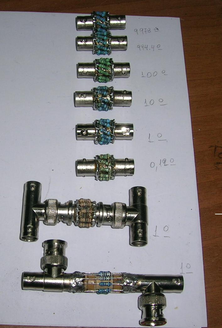

I spent some more hours to build a set of cvrs 😀

Its also not Litz.
Of course it is. It's called Type 2 litz.
And when you take a number of strands of individual wires, twist them together, and then take a number of those bundles and twist them together, as with a rope lay, that's what you get. Each individual wire on average over a given length will occupy all radial positions from the center outward.
