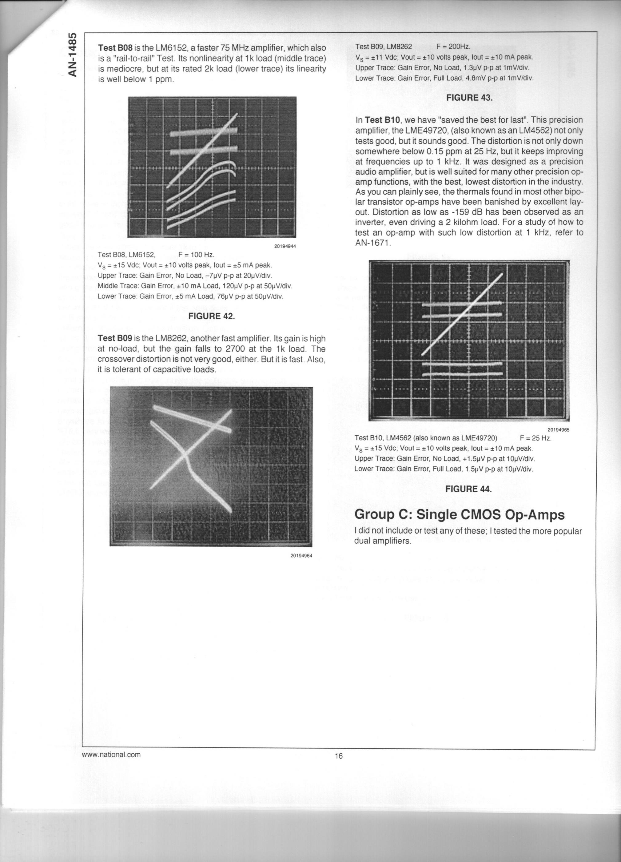

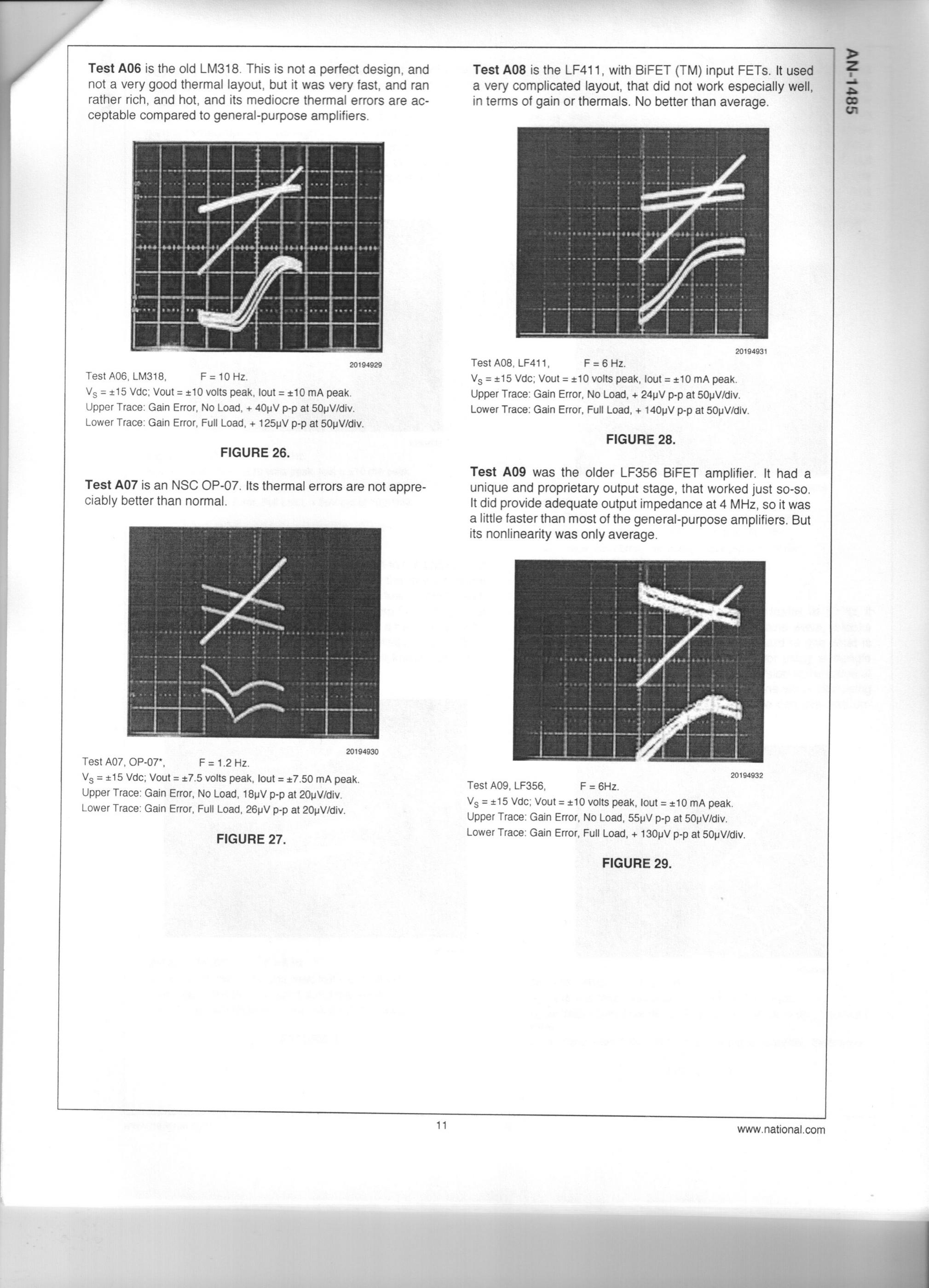

OK, let's look at some OLDER and some NEWER technology from the same study:

Now, looking at older IC's vs the mighty LM4562, we can see that the LM4562 is pretty good, BUT I have still found problems with it when it is loaded down excessively. I agree with PMA that virtually every NEW IC has its own personality profile, as that is what I have found with listening tests, so far.

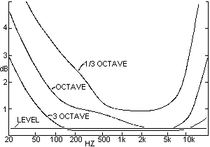

typo? - of course you can DBT "We matched the output levels of both D/A preamps to within 1dB "
0.1 dB is really the level match needed according to Clark's ABX tests
Clark, David L., "High-Resolution Subjective Testing Using a Double-Blind Comparator", Journal of the Audio Engineering Society, Vol. 30 No. 5, May 1982, pp. 330-338
ABX Amplitude vs. Frequency Matching Criteria

BTW controlling the temperature of the top surface of the package would not change any of those plots John posted. Unfortunately I no longer have a TEK op-amp curve tracer plug-in that functions or I could show you.
THEN, Scott, you CAN'T even show us TEK op-amp samples of YOUR DESIGNS. Too bad. MY 40 year old modules measured a virtually flat line, and the test were next to useless, but the IC's that I tested 40 years ago, looked like what the app note showed.
BIG DIFFERENCE!
