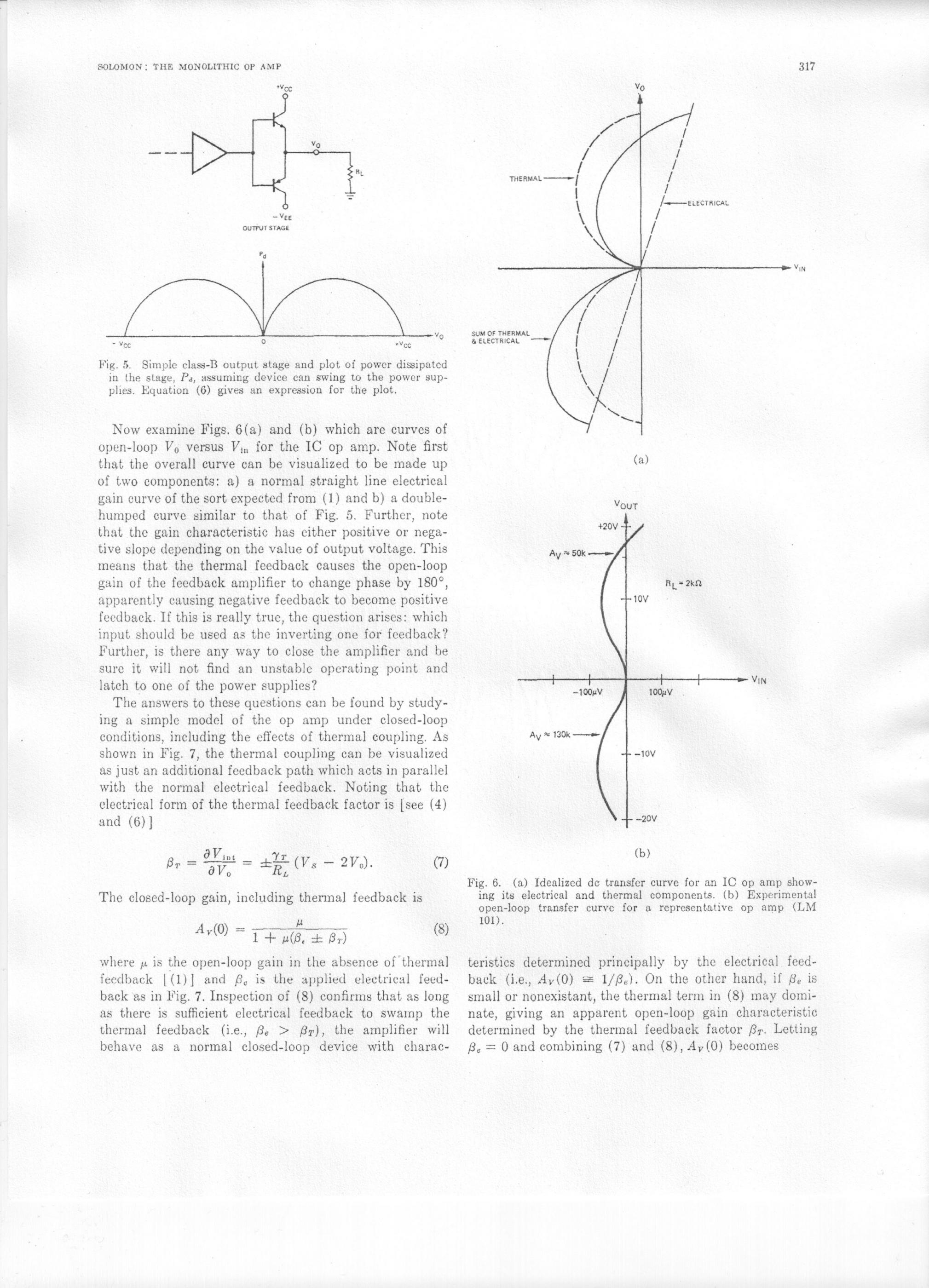

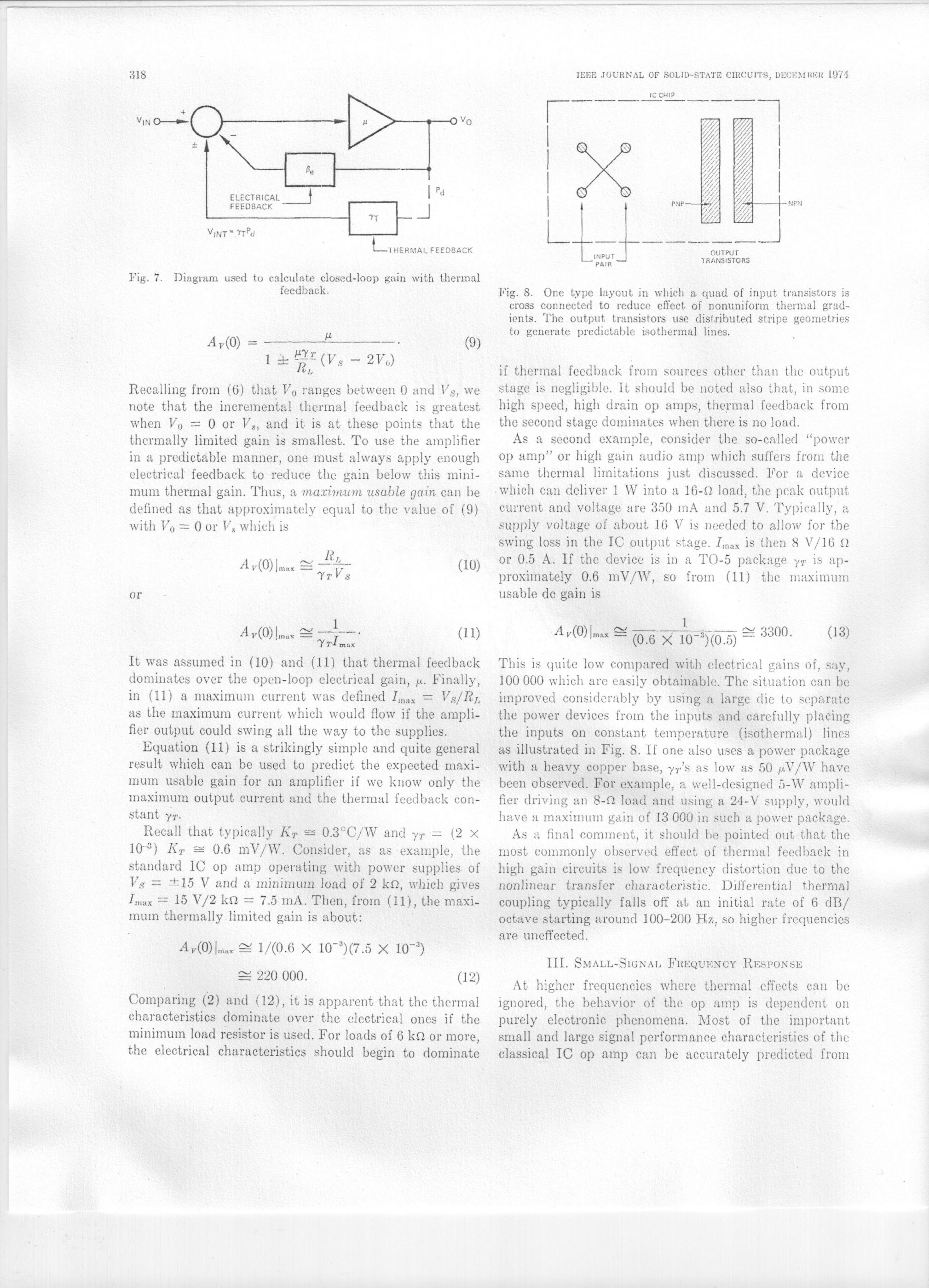

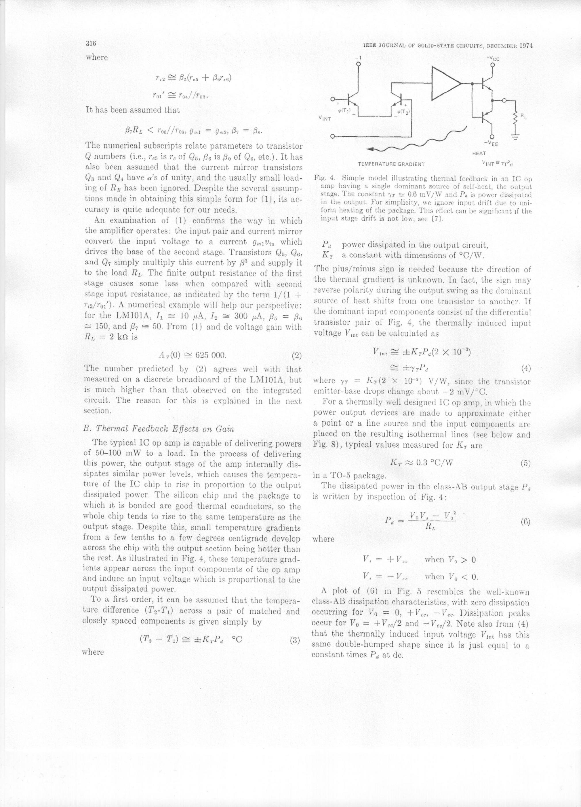

Solomon's calculations:
This is tired old school stuff problem solved move on. You can do the wrong thing and get burnt so what?
