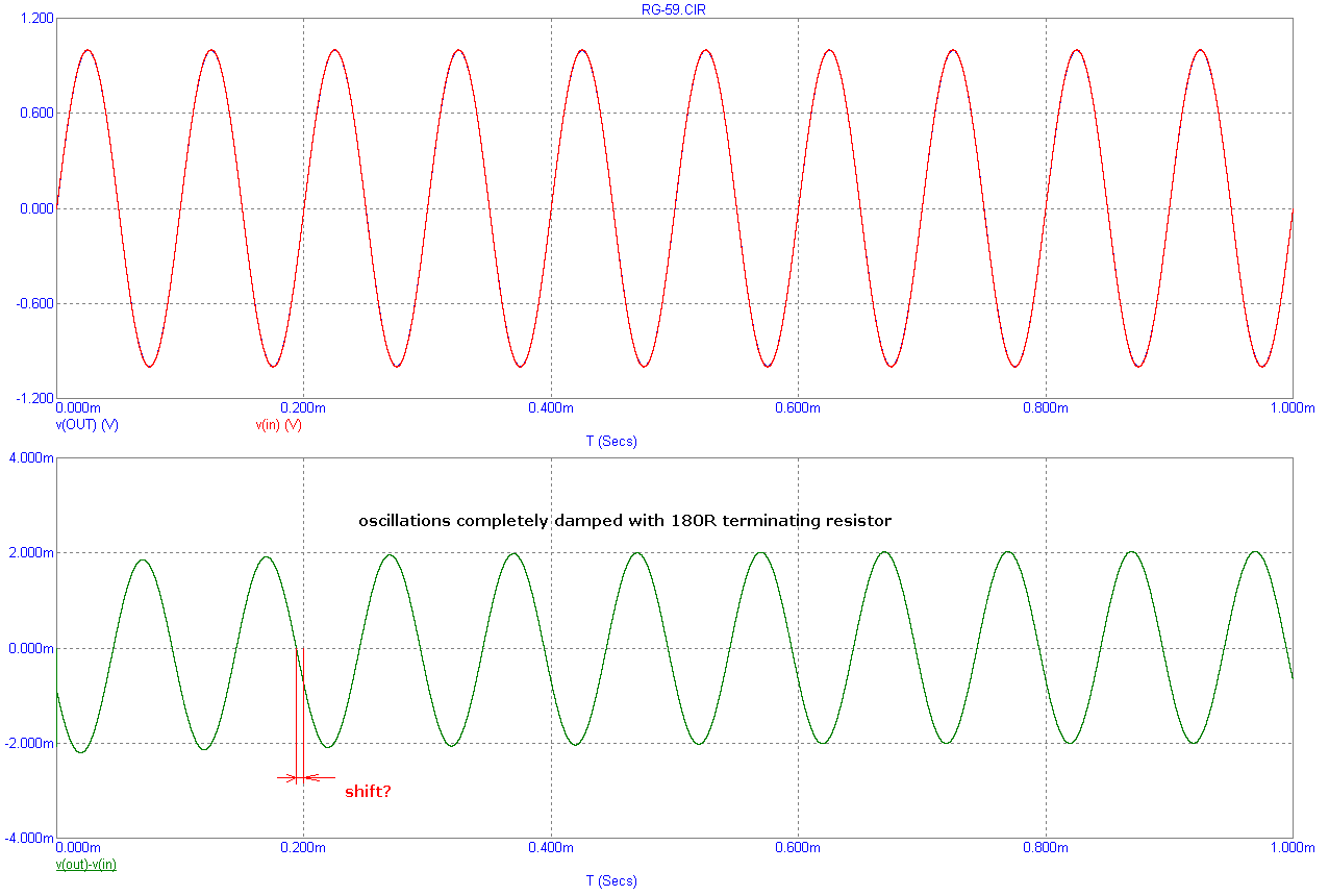

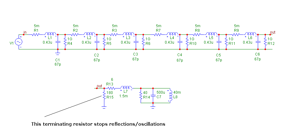

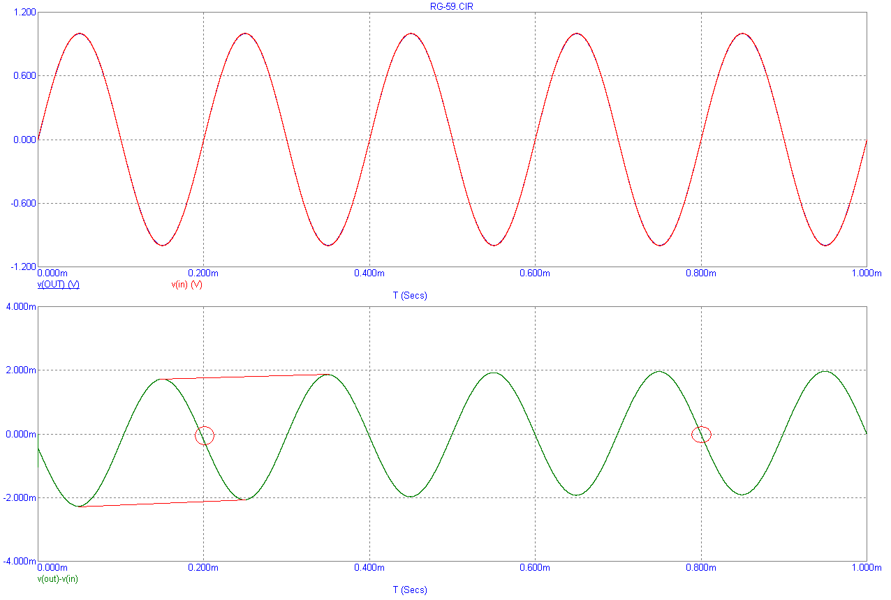

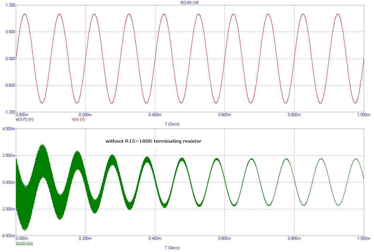

This is what we get as early reflections. These reflections are caused by sudden turn-on of the sine wave in the voltage zero. This turn-on has infinite spectrum, so it excites reflections/oscillations that disappear after some time.
This is similar to so called 'first cycle distortion', similar misconception.
I have tried a simple termination with 180 ohm resistor at the end of the lumped circuit model. All the oscillations/reflections have disappeared, see images.
I have also tried a model based on telegraph equations only, still not sure what to think about (no images shown re this model).
The "shift" is frequency dependent and initial transient (turn-on) dependent. It also grossly depends on speaker+crossover lumped impedance, and cable lumped elements impedances.
The effect of the additional terminating resistor is easily measurable as a decrease of RFI interference amplitude on the cable and speaker terminals.
