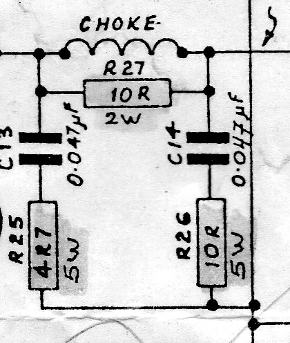

This series of Mosfet amplifiers found quite common usage in PA applications back in the day....early eighties.
There are still plenty out there in faithful service in many installed and mobile pub/bar hire rigs.....every local PA audio board level tech/service center will know how to cure them.
In this case, most of the cure is physical.....dud solder joints (soldered then cut, flux left behind.....these things get to run red hot for hours......der.
The B+ and B- 80V rails are long thin tracks, closely adjacent to each other,.....heaps of dust, smoke machine fluid, humid room.....der.
Cure is to beef up the long tracks with telephone wire strand the full length, cleanse and then liberally apply conformal coating.
Tweaks is choosing input and NFB shunt caps, local rail decoupling electros, and they're good to go long term.
They are then quite bulletproof, and have that old school, clear, pretty clean, mosfet sound.....good amplifiers.
These amplifiers get used with a range of loads, combined with reasonably long speaker cable runs, in what can be a magnetically (and AC supply) noisey environment....dimmers hash, bar fridges....etc.
I have never heard these amps to misbehave.
Anyway, there is a very wide range of speaker loads out there, some particularly/spectacularly low impedance, and also can be very reactive . (There is discussion about speaker loads and amplifier current capability over at SQ vs Measurements thread)
So, Mike, you are very good at SIM, I thought a discussion of a representative range of speaker loads might be interesting.....ie simulated real loads.
Typical 1/2/3 way, planar electro and magnetic, a few renowned 'difficult' speakers ie Wilson, Quad, etc, combined with differing output networks, with differing circuit values....that sounds like a lot of permutations, but should be easily whittled down.
The point of this, is it worth doing some investigation into optimizing output networks according to the particular amplifier and the particular loudspeaker that is connected, via a particular cable ???.
Is it worth fitting networks to amplifiers that do not otherwise need it ???. .
Or is the generic kind good enough for those of us stuck with those simply awful loop feedback amplifiers ???.
Just thinking out aloud.
Dan.

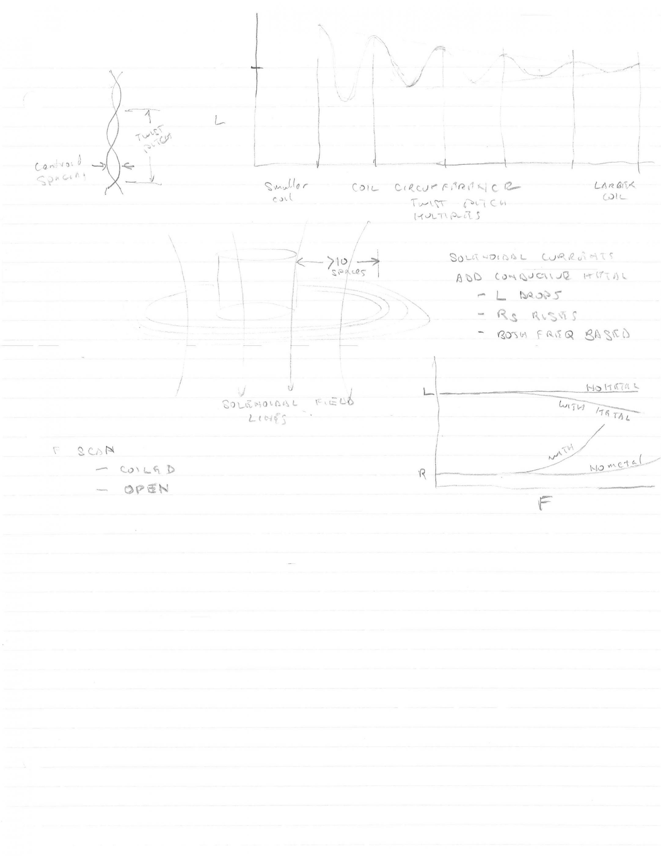

I've some 50 foot ling mike cables I built 8 years ago from parts express, red in color. I don't have any data on the wire itself, not even a sample of the cable to determine pitch.
After the holidays I'll be able to perform some experiments on one or two of them. I've a scan I'll attach in the next coupla minutes with some test details and concepts..
Bummer, pencil doesn't come out with enough contrast.
Upper right, just a depiction of twisted pair showing pitch and centroid spacing definitions.
Upper left, a graph of inductance vs coil circumference for close packed single layer wire on a non conductive non magnetic form. In the limit of very large form, there is no inductive shift. As the form becomes smaller, the pitch coupling will alternate between maximum enhancement and maximum cancellation, the growing sine modulation of the inductance. It gets larger as the coil circumference gets smaller because there are more places where the pitches line up.
In the middle is a depiction of a coil of wire, magnetic field lines generated by a solenoidal current, and I've drawn in a cylinder of material to disturb the reluctance path of the field lines. I set a limit of 10 centroid spacing gap between the conductor and the cable to reduce the possibility of coupling to the centroid gap generated dipole field, "near field" disturbances. This test is designed to determine if any solenoidal field is present, as the conductive object will fight time varying flux. A positive change here would indicate that Ed's premise is more likely to have some credence. A negative result here would mean there is no solenoidal field being generated.
Lower right is the bog standard L and R vs frequency relationship.
jn

I've a 3 ring binder with 20 sections in it, with various things like the thermal paper I'm (still) working on, changing, embellishing. The scanned page is from that notebook. I'm really annoyed that I've done the entire book in pencil, and it really doesn't scan well...🙁
I decided that I'm not going to simply react to some "net" person tossing bad photo's of bad tests with dialogue along the lines of "here's my proof, you do something to prove me wrong". That's too grade schoolish.
I prefer being a tad more rigorous, as do you.
I am deeply interested in this test aspect, as I'm responsible for proper cabling routing of roughly 250,000 kilometers of multiconductor twisted pair, all with lengths in excess of 100 meters, grouped in bundles of between 30 and 90. External communication between pairs, and from pairs to external aluminum or steel ladder tray and metal conduits from 3/4 to 4.5 inch ID is of significant importance to me and the "customers" I service.
Hope you have a happy holiday Sy.
john
ps. on the previous post, when I say "left", I mean my other left...and "right" means my other right.. at least I got top and bottom accurate..
pps. gonna hafta switch to pen.
