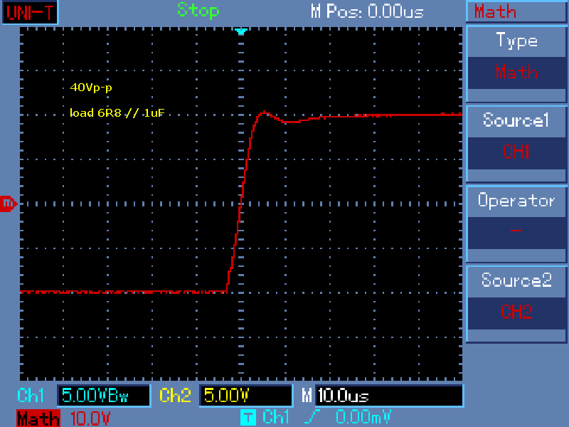

It is similar, not same. There is not much to 'investigate', the best in this case is complete symmetry (with complementary-differential input) of both input and output to get distortion cancellation and PSU residuals cancellation. Balanced output with speaker not referred to ground brings about 30dB better PSR compared to speaker output with one terminal grounded, not many people probably realize this immediately. One have to design, build and understand.
Someone mentioned a 'toy', yes this is a toy, not meant to be produced in more pieces. And I like this toy very much 😀.
We are in a BT thread, and there is a strong similarity as well, but at power level.

No problem Mike, input devices are IRF510/9520 (they run hot above 1W) and output devices are 2SK413/2SJ118.
And it is completely stable into any load with no compensation ?
I have the feeling you like how this amp's performs . . . any thoughts about it's noise levels ?
I would be tempted to set the gain about 23db . . . would you envisage any problems with this ?
edit - I wonder how it compares to the JLH Simple class A you revisited a few years ago
It is completely stable to any load you may imagine. No feedback power amplifier I have ever built was as stable as this one. Attached is step response to 6.8ohm + 1uF in parallel. Noise is not very low because of input MOSFETs, but they are operated at quite high idle current. S/N = -86dB/2.83Vrms unweighted, over 20Hz - 20kHz bandwidth. The noise bottom is similar to 1/f.
It is really not intended. I built it to satisfy my curiosity. You know I do not like empty debates too much 😉.
