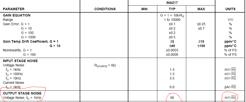

For better understanding of the advantages and tradeoffs discussed here in input topologies, I might elaborate a little:
INAMPS are the abbreviation of Instrumentation Amps, and have been used for many decades. They are essentially high common mode rejection balanced inputs that are relatively unaffected by source impedance and other factors. 120dB or 1 million to one is possible at low frequencies, and various discrete versions and IC versions have been made over the decades. One common type is the so called 3 amp configuration, composed of 3 op amp type designs put together to make 1 gain stage. This is apparently the type of gain stage mentioned recently here by Joachim, and is the usual front end of our distortion analyzers, from HP, ST, or AP.
This type of stage is relatively 'bullet proof', but it has the problem of being about 6 dB noisier than the quietest discrete or IC configuration, due to the fact that 4 devices are in SERIES at the input. This is what makes it twice as noisy as what is possible.
When working with MC cartridges, this can be a problem, as their output level is so low.
High values of inner resistor network --> high output noise, the real issue :
This leads to what is the BEST way to make an input stage for MC cartridges. At the moment, I am designing two separate phono preamps with different inputs. One is single ended, the other is balanced. Neither is the traditional 3 op amp type design.
This is in an effort to keep noise to a minimum, as the 3 op amp approach is the noisiest option.
With transformerless design, the quietest approach is with single ended input, because the active device that are in SERIES are minimized. In fact, for the SAME number of input devices, you can get a 6dB improvement in S/N, by paralleling the previous series devices. This is the approach used in the Vendetta Research phono preamp, and recently in the JC-3 phono stage.
