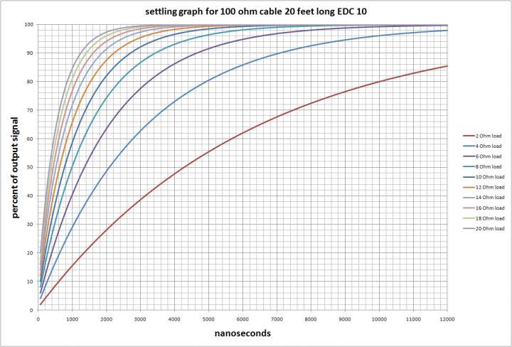

While I seriously doubt that anything on this planet can be called off topic within this thread, I wanted to post a tidbit regarding this statement.
Here is the t-line analysis of a 100 ohm line fed by a low impedance source into various load impedances.
Note that despite the fact that it is only 20 feet long therefore incredibly short with respect to audio wavelengths, the settling delays reach quite far into the human ITD thresholds. And that is neglecting the rise in impedance typical for cables in the audio range, as real t-line impedances are factors of 3 to 4 higher there, which scales the delays proportionally so.
Delaying a specific band of frequencies of an image on both channels where the panning IID has placed the image significantly off axis results in a placement shift of those frequencies with respect to the primary image component.
Too many believe that the propagation speed of a cable defines how fast all signals will flow through it. That is only correct when the signal has the voltage and current relationship consistent with the cable's impedance. Speaker loads and zip cord type wire do NOT propagate the total energy to the speaker at the line's propagation speed. It settles based on the line to load/source ratios. Cyril Bateman actually displayed this via a modified RF bridge.

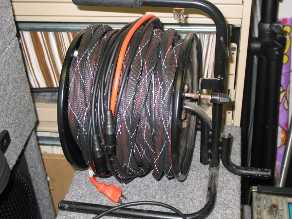

I see from your diagrams that one way at least to reduce ground loops is to tie or wind interconnects and mains cables together. That is a hard sell to people who have been told time and again to give plenty of space between the two, and if they do have to cross make sure it is at a 90 degree angle🙂.
Rob.
Rob.
Absolutely. the concept is so counterintuitive that many just ignore it.
It works extremely well however. I actually made a snake using a 100 foot extension cord, a mic cable, and a single ended line level cable, wrapped the three together and put braid over it. It remove all traces of noise and hum. I knew that concept worked for me previously, it followed theory, but I still marveled when I put it together and the darn thing worked perfectly. My roadies loved it as well...they were 10 and 12 years old at the time.
Here it is. I'll add it to my gallery as well.
And NO comments about the power puff girl wrapping paper!!
jn
ps. Just try not to have the twist pitches of the cords match the twist pitch of the extension cord. That would negate cancellation by common centroids, and even a balanced cable would communicate with the line cord currents.

JN,
Should we assume that you braided those three cables before you covered them or are they truly running parallel to each other? I'm voting for braiding from some of your past comments on power supply wiring.
No braid. Just loosely wrapped around each other.
Almost parallel.
Don't forget, the line cord has it's twist pitch, the mic cable has another, and the stereo line level cable is the same as the mic cable. The line level cable is actually 125 feet of mic cable, but I run left and right inside the same cable, with a common shield return. Not the best setup for prevention of crosstalk, but the spool wouldn't hold an additional 125 feet of mic cable to make left and right balanced.
The only concern is to make sure the twist pitches between a balanced cable does not conspire with the line cord pitch and magnetically couple. Cat5e cable does that, they have 4 different pitches internally to prevent magnetic coupling inter-pair.
If you run a dingle ended coaxial cable with a line cord which has twist to it, you don't even worry about twist, just put them together. My case was a tad special only because in the mic cable, neither core wire is coaxial to the shield, so there is a very small possibility that they accidentally communicate if pitches are the same.
