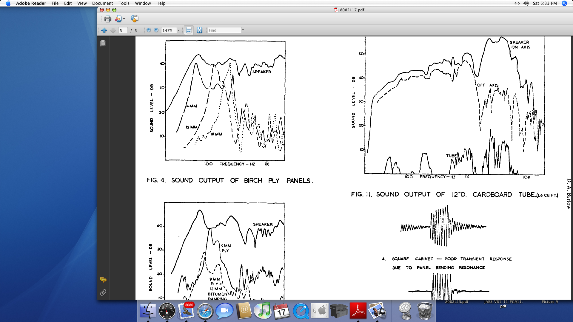

Where is Iverson's paper? I would like to read it. For ME, even working with the 'GD Wall of Sound system', owning K-horns and talking with Paul Klipsch for years, even Richard Heyser, and spending 1 1/2 years designing speaker systems with John Meyer, it was Barlow who first gave me the insight about speaker enclosure resonance Q.

The graph from Barlow in 1975 that taught me:

In the 1960's, I started out with an AR-1 loudspeaker that was one of the first 'acoustic suspension' designs. It was a fiberglass filled wooden cabinet. I doubt that it had any extra bracing inside. Then I sold and installed custom cabinets made by Klipsch. They didn't seem to have any extra bracing inside and the thickness of the wood was not to great. Then, in 1970, I was introduced to the Grateful Dead custom cabinets that was proudly made with 15 ply Finnish birch. They were heavy, sturdy, and seemingly inflexible, but they did have a 'signature' that I still remember today. It was years after I left the Grateful Dead, and was designing my own speaker cabinets that I came across D.A. Barlow's papers at the Lon.1975 AES and noted that the Q did NOT really change with the thickness or even the hardness of the material that made the enclosure.
Some sort of 'damping layer' had to be put inside the cabinet to lower the Q, and not just some fiberglass stuffing, as I normally used.
For those of you who want to note what I learned please look at the graph that shows the response with different thicknesses of wood.
Then note the other graph that shows the advantage of dissimilar materials making a composite cabinet material.
Dave Wilson's speaker cabinets are light years ahead of 1975.
Yes, because the two perform completely different tasks. The fiberglass used inside the cabinets is to absorb sound within the cabinet. It's called dampening. Something quite different from damping, which involves adding loss to a resonant system in order to damp said resonance.
Yes. For a given size panel, if you use thicker material, the panel becomes stiffer and it raises the resonant frequency. Which is a good thing as it tends to be easier to damp a higher frequency resonance than a low frequency resonance.
It's not so much about using a dissimilar material, but rather using a lossy, elastometric material to better damp the resonance.
As I said, this is just some pretty basic physics. Didn't you already have a BA in physics by 1975?
