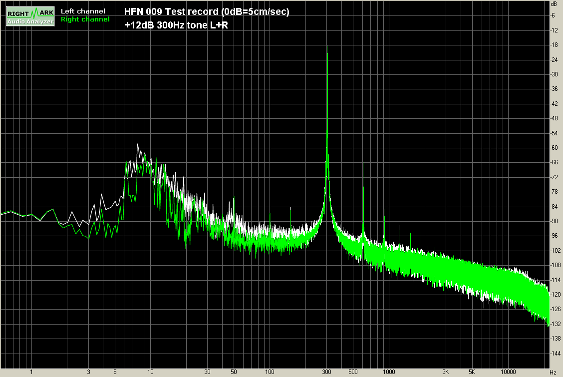

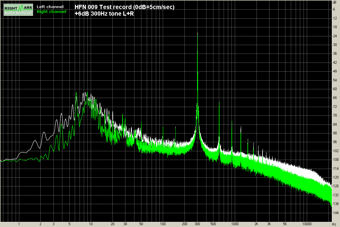

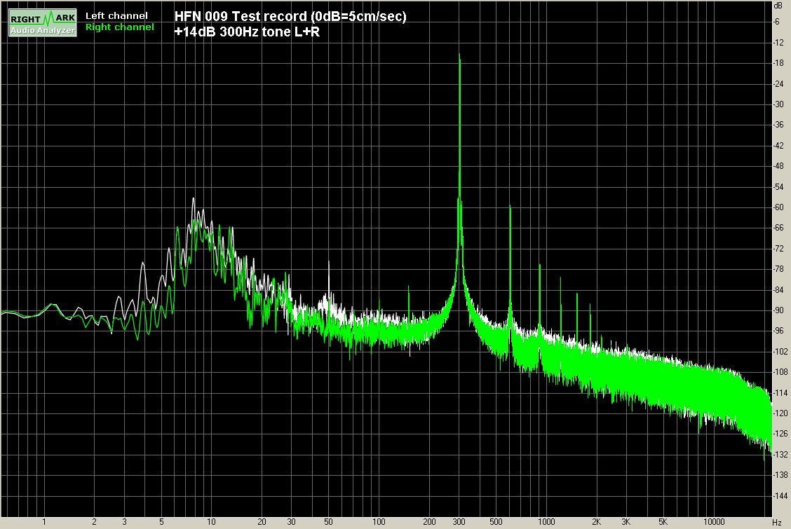

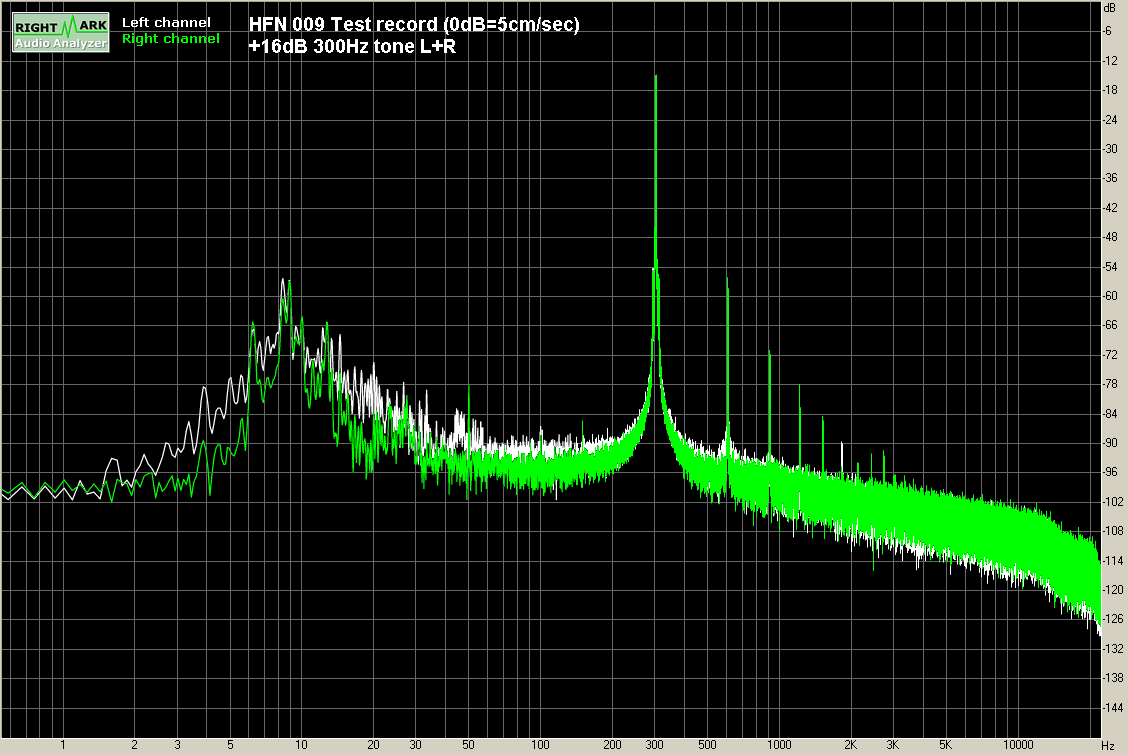

So from an informed perception viewpoint records do have a greater dynamic range.
The matching distortion makes it sound louder than it is.
The distortion increases with the modulation.
More distortion components= louder perceived sound
Also
More distortion components= more extended higher frequency content
Or as Rocky and Bullwinkle would tout "Sometimes what you measure ain't what you hear."
We should too think of "Sometimes what you hear and you prefer it, ain’t what was recorded" 🙂
