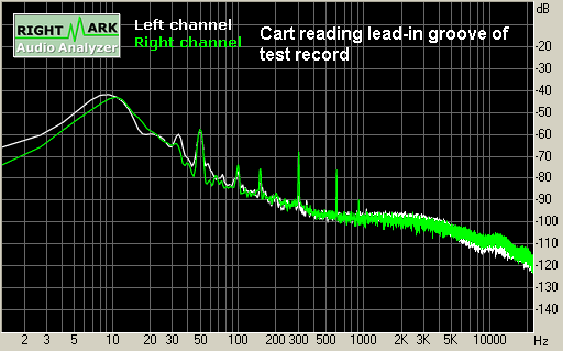

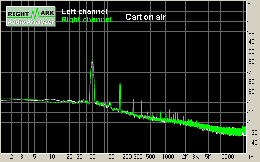

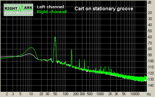

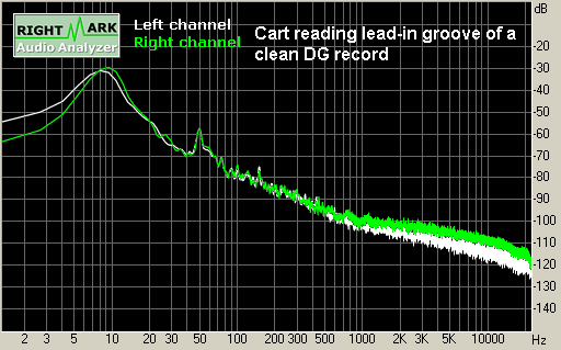

Groove noise:
Don’t pay attention on 50, 150, 250, 350 Hz peaks (it is a ground loop issue) but see the noise profile.
The quantum demons have to work hard mostly below 1kHz to clean up the record noise
Well, I was there, at Jack Bybee's house when he made a before-after addition to the input of my Vendetta Research SCP-2, and the groove noise virtually disappeared! What can I say? That it didn't disappear? My associate heard it too, and he does not believe in much. Now, I have a pair of these devices that Jack made, but they need connectors attached, etc, before I can try it myself in my own room. We shall see, if I can duplicate this 'improvement' independently.
Mr. Curl
When you will be ready, please make a groove noise recording before and after installing these devices and study the spectrum.
George
