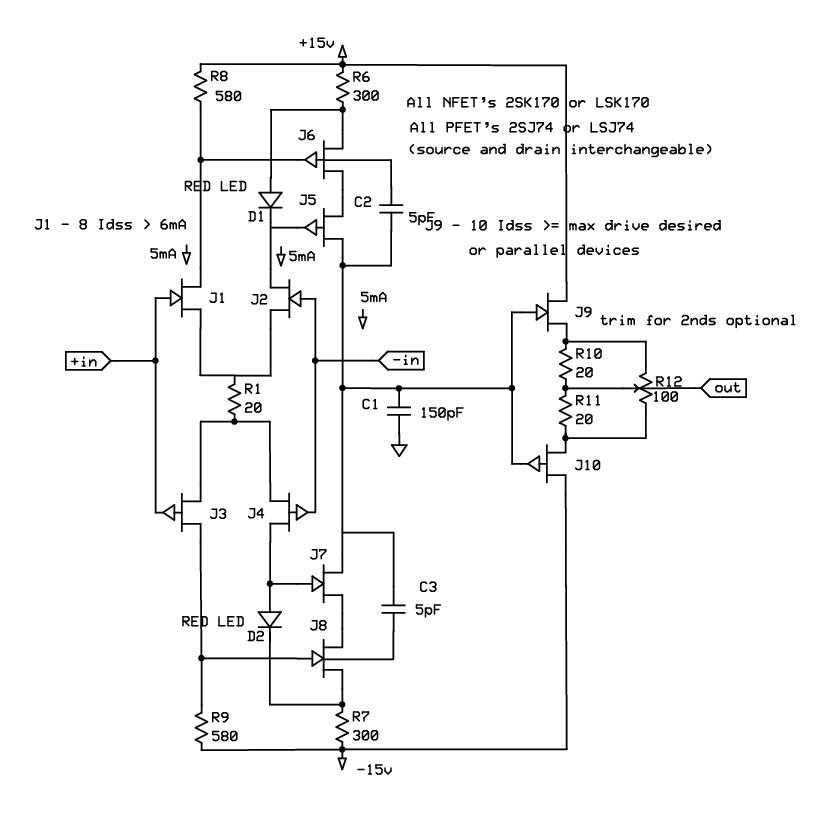

Well of course, Scott. I, too, started with the IC op amp, then I switched to the discrete TA, then added a discrete op amp, etc. I have personally found that less feedback is better than more feedback, unless it is for test instrumentation. THEN, I have even gone so far as to use 2 pole compensation for MAXIMUM FEEDBACK at higher frequencies.
One last one
for now, the resistors collapse to a single 20 Ohm and the noise is better. The higher gm needs a couple of small comp caps but this one looks to be stable down to gain of 2 (sims of course). Aol is 126dB and 70dB at 20kHz just like you know who. See JC's circuits are all we ever needed if only IC's had two flavors of FET's. 🙂
Looks good Scott. I have built this before and the values were within a few Ohms of what you have also ran it with the followers outside of the loop.
