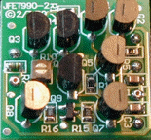

The last modules by Forssell looked like this. I can count more than 7 transistors..
EDIT: Found some more info
"The JFET990-2 uses 8 large source geometry JFET transistors and one NPN transistor (for DC control). Unlike our first generation design the JFET990-2 is differential throughout. It has the standard opamp topology's differential input ports and a single output port. Techniques are used within the JFET990-2 to reduce the input capacitance, however no cascode amplifiers are used. The result is an amplifier with a very simple signal path that has wide bandwidth (-3 dB at >2 megahertz), high slew rate > 60 V/us, and fast rise time (150 nanoseconds)"
P.S. It probably still leaks at +/-24 Volts
