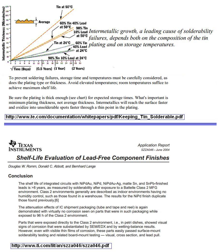

To scrape or not to scrape?
George
That is the question...
strangely, your appnote, lower one, has a title including lead free as a descriptor, then includes tin/lead in the text..

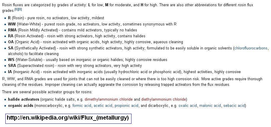

8 years. I believe we can assume they used RMA flux in their wetting balance tests.
Mil spec requires R.
I can solder to the copper tin intermetallics if I get some plumbing paste from home depot...
But not if I'm stuck with R.
jn
JN,
Wouldn't that solder paste at the hardware store cause major problems? I use that for soldering copper pipe but I would think the acid would be very aggressive for electrical connections. How would you neutralize the acid content after soldering, sodium bicarb?
If you go back you will see that I stated "baking soda is your friend".
Some flux manu's sell neutralizing solution as well, if ya gotta go hi tek..
jn
I should have been clearer, my apologies. I stated baking soda about a thousand posts ago (probably yesterday given this thread), should have repeated it...
I really hate the active stuff, as cleaning off corrosives is not my preference.
But if ya have to use the active flux, it is very important to neutralize the residues and get rid of all of it.
jn
jn

As far as I understand, solderability problems start when tin on the plating is “exhausted”. This is dependent upon tin plating composition and thickness, component storage time and temperature.
How can I ever know all these when I buy components from a small retailer?
I can’t. But I can do a test. I solder the end of the component lead on a pcb. If solder flows well on the lead, tin is OK.
If it doesn’t flow, then I’ll have JC scrape the leads down to the copper.
Is this good enough Dirty Jneutron?
In all the papers I’ve read where lead free solder tests are reported, tin/lead (60/40) is always included as the “reference” solder.
George
For the record, about 25 years ago, we tried to 'streamline' the process of cleaning leads.
We investigated ultra sonic cleaners, fine sandpaper or emery paper, steel wool, and even powered sanders (from construction), and exotic chemical combinations from CAIG LABS, etc. but there were extreme tradeoffs in each approach. We finally went back to mechanical scraping, when we could.
