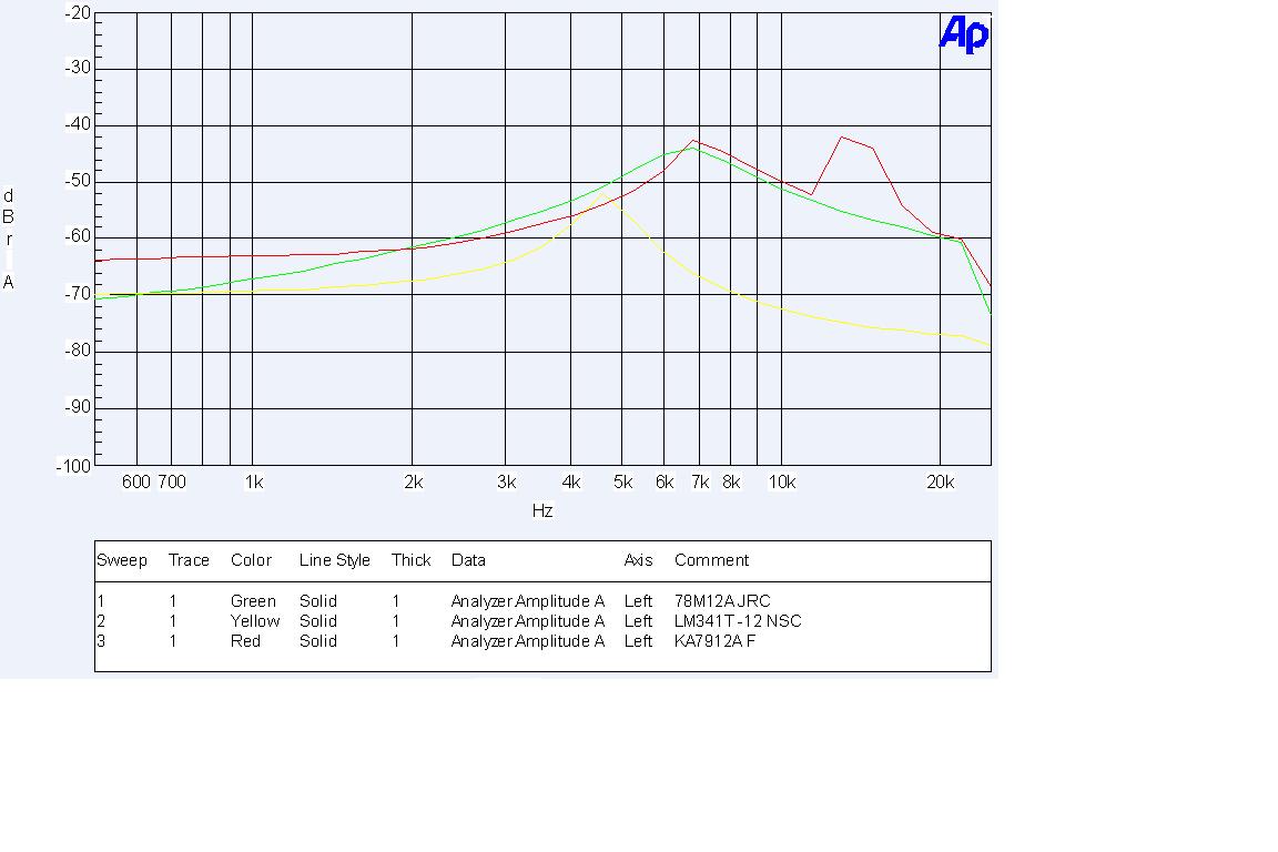

For the Peanut Gallery here as some PSSR curves for simple IC regulators. Input is DC with a sine wave added.
