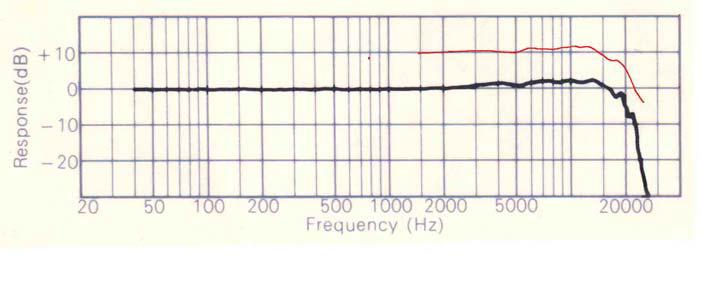

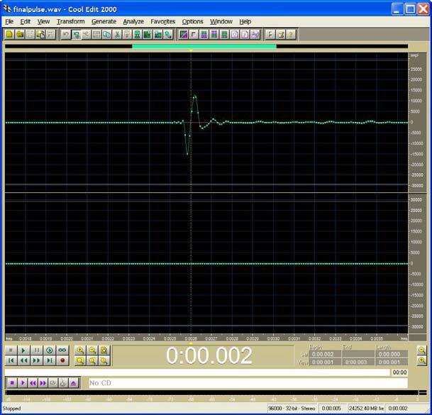

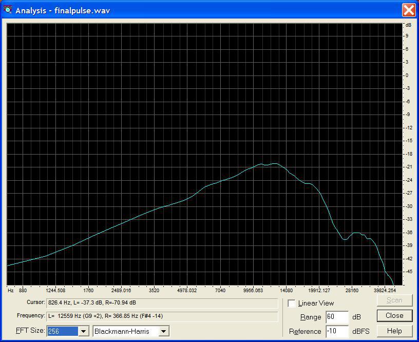

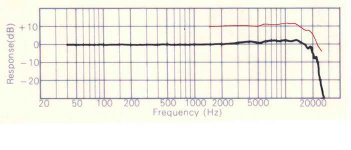

It's buried in some online archive. Here's the pictures 🙂. The spark gap was at the end of a 1 meter dowel and the push button piezo-zapper was another 1.5 or 2 meters behind that. Everything was dangled out in the room so there were no reflections for about 5msec. Pulse, raw spectrum, corrected response. It turned out the pulse is mostly a doublet up to about 10kHz. Above 10KHz there is a correction which takes about 20 pages of horrible maths to derive and of course involves Bessel functions. Luckily the 10-20kHz region is easily approximated because it falls below the first null of J0 (or something like that) 🙂
EDIT - The red line is my measurement offset by 10dB. My original reference had a less sophisticated derivation of the high frequency effects but was still accurate to 20K or so, you can sort of see the first Bessel null just before 30kHz

Good. You have used the noise generated by the spark to produce a wide band acoustic signal with consistent and repeatable signature for to measure the frequency response of the Nakamichi CP3 microphone.
You verified the results (red curve) against the manufacturer’s data (black curve)
In your “to do list” is to repeat the same procedure but with one (or more) capacitor(s) in place of the CP3.
Yes? 🙂
