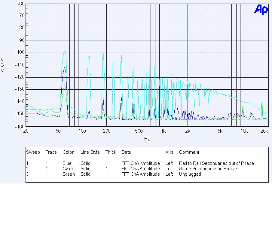

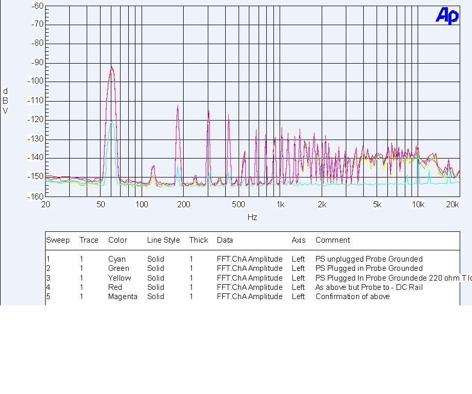

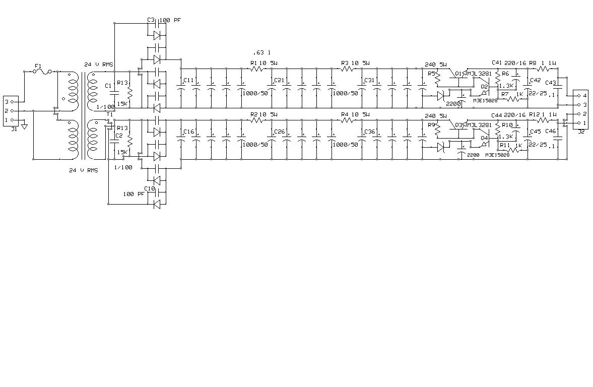

In doing my power supply article I found that there are a number of audiophile design facts that I was unable to verify. Some others stood up well. Then there were a few new tricks. This is my microphone preamp power supply.
Note the transformer secondary reversal, that really got rid of even more noise than is shown in the attached AP plots. Right now the noise measured from rail to rail is around -150 dB re 1 volt. My design goal is 160 dB, so I may play a bit more.

Why do you not have resistors in series with the caps across the diodes and the secondaries?
Because the damping resistor (15K) is in parallel! You might need to take a closer look to see how the same resistor gets the transformer's capacitor and the diodes'!
Attached is the difference in output noise from the secondaries in and out of phase. The baseline is with the power supply unplugged.
