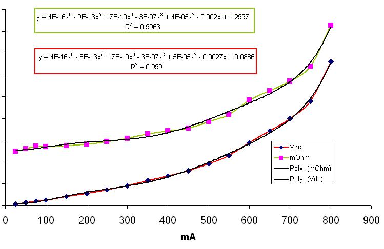

But there is a very interesting phenomina that occurs with fuses that is shown in the chart!
I made a diagram with your data (resistance is in milliohms) to find out what you mean.
The interesting thing for me is that there has to be a 6th order polynomial (!) to fit the curves.
Differences shown in the two equations are at the coefficients of the 2nd and 5th order.
It’s your turn now 🙂
George
George
What I get from the data is that a fuse should in use carry 20% of its rated current for the least non linear effects.
ES

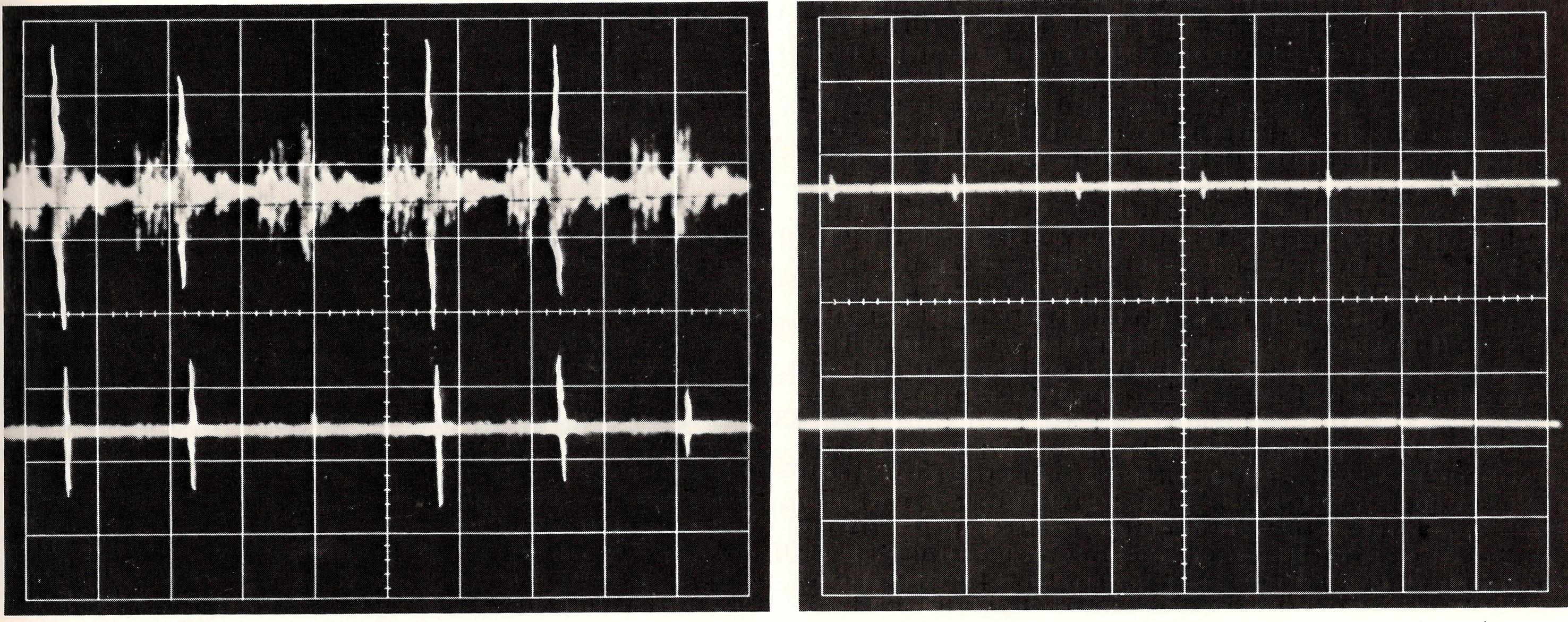

Months ago, I put up here some spectrum data photo's of the freqs put onto the ac power line by audio/vidio/computer systems in the house.... the spectrum is from audio to FM/TV freqs. What are some voltage levels which could be found in the home.... See attached for Normal-Mode (Differential Mode) on top trace and CM or Common-Mode and what a simple filter can do. Scale is NM=4v/div, CM=2v/div and after filtering is .4v/div
Thx-RNMarsh
