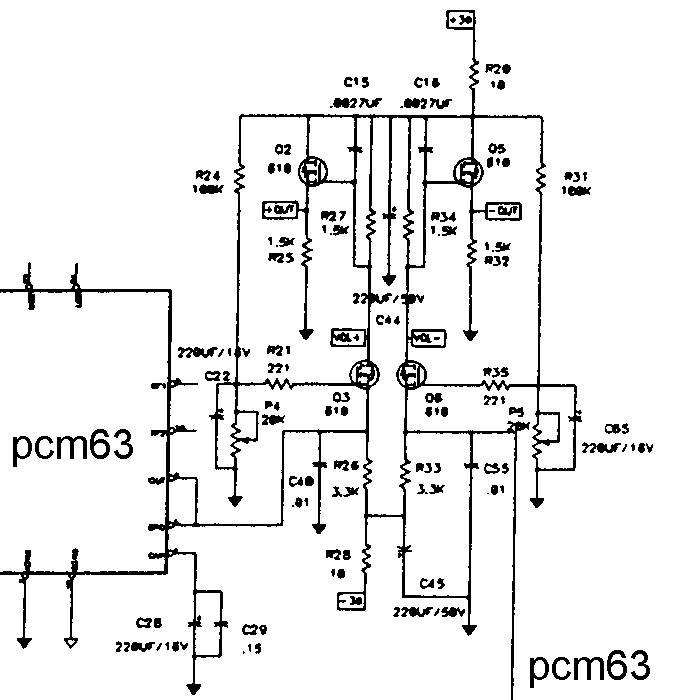

Hawksford's multiloop op amp I/V ? - seems like someone should try it someday - it does have "Guru" cred...
http://www.essex.ac.uk/csee/researc...Current steering transimpedance amplifier.pdf
We used a similar sort of Common-Gate mode input in '97 on our D1. Using
a fet there reduces potential rectification issues. Worked great. Low
distortion, no feedback.
It was updated more recently as the "Zen I/V", a complementary version
using Jfets posted on this site.
