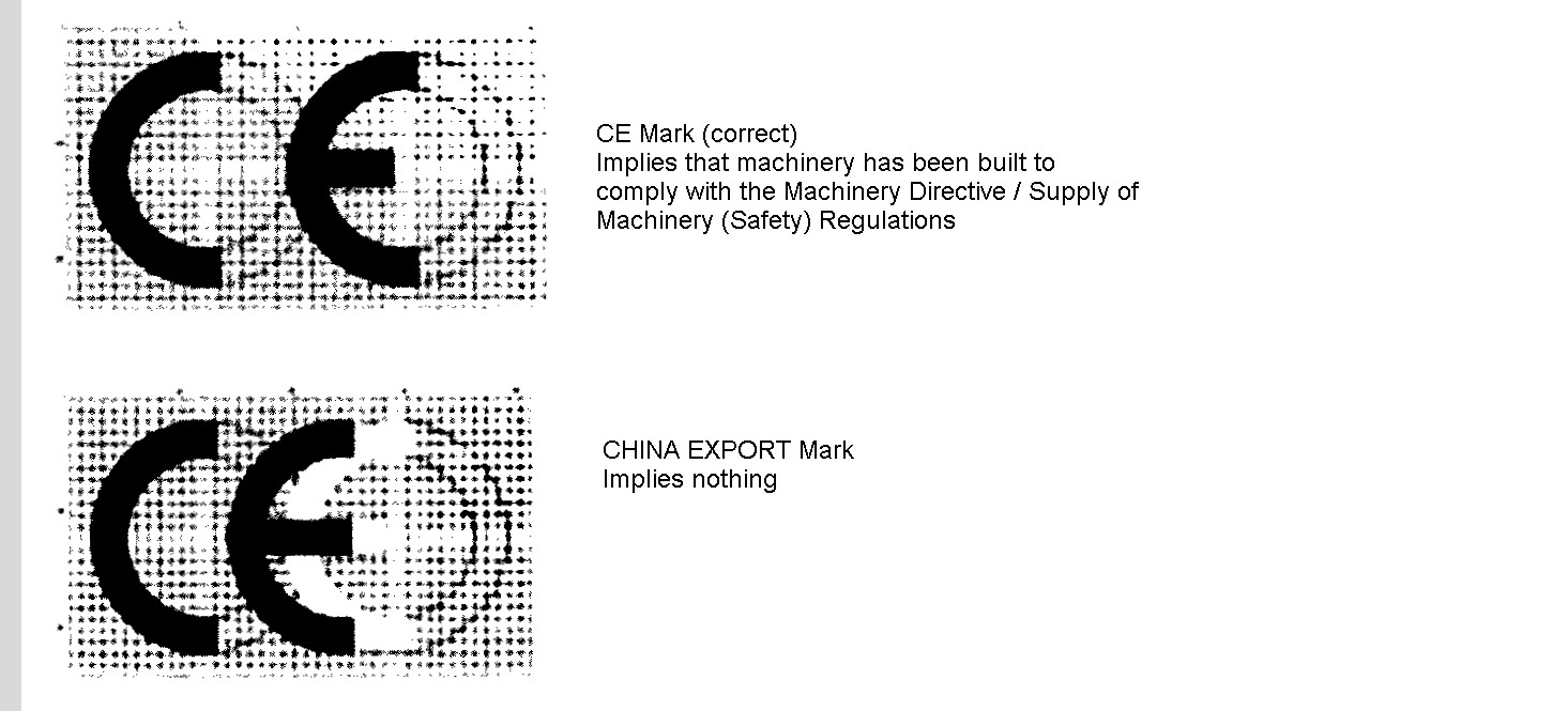

CE marking
As I understand it, you need CE (and lead-free?) to place something on the market in Europe. Personal imports would bypass this system, but in the event of a fire your insurance company might ask some questions.
In the UK CE marking is not seriously enforced so all sorts of (mainly Chinese) junk comes in, with or without CE stickers
Remember that the Chinese are copying everything. 😡
