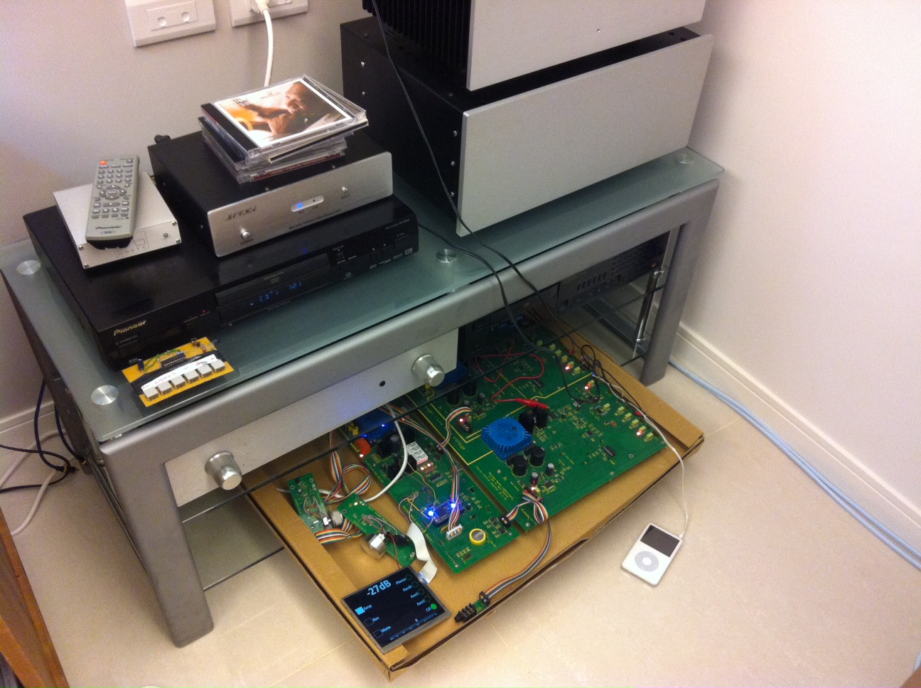

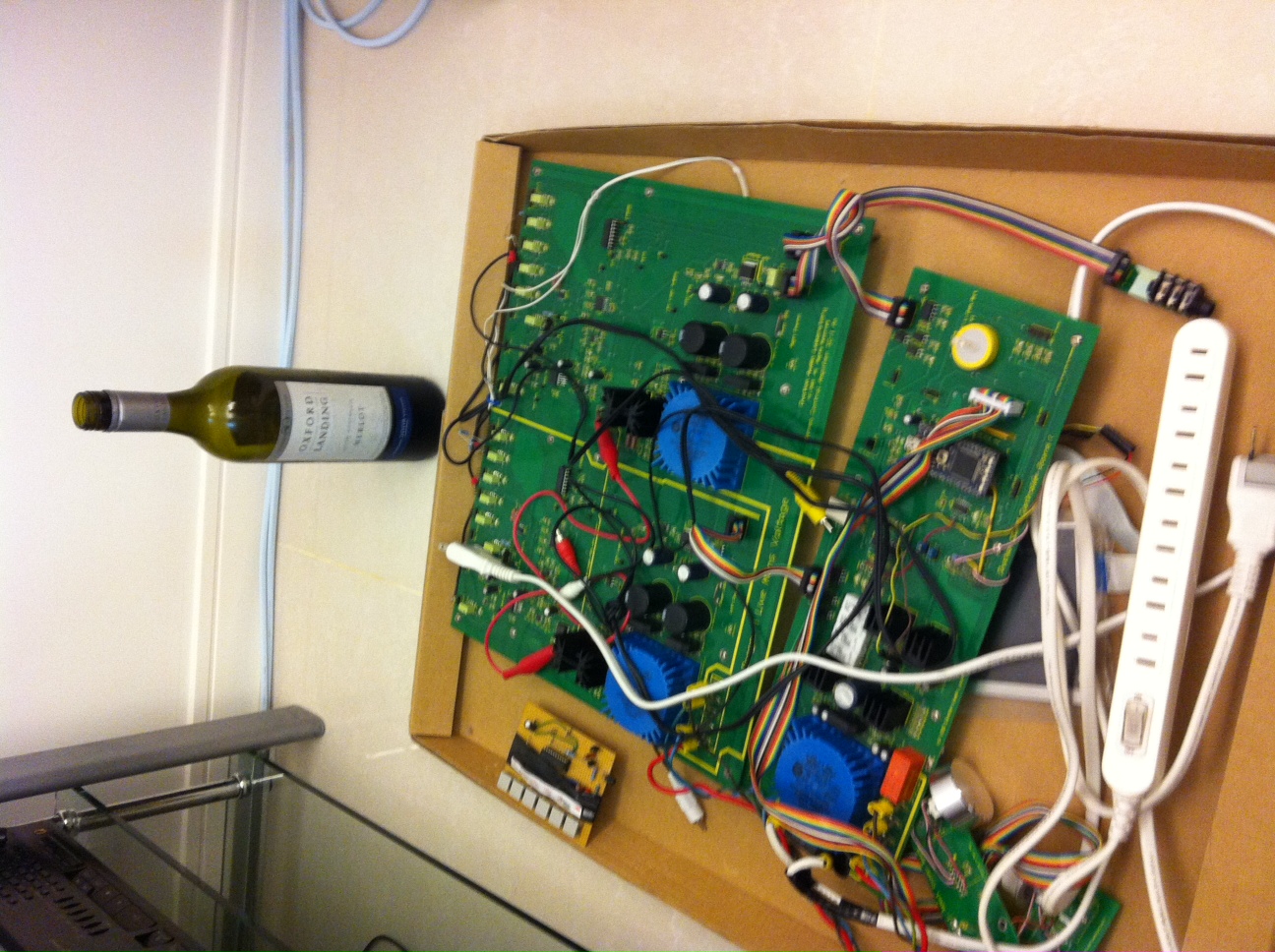

Here it is. I am amazed at how quiet it is - you have to stick your ear right up against the tweeter to just hear something - and its unboxed so I am talking about hum as well - zero, zip, nada and I am operating it in single ended mode. The PGA2320 operates at unity gain with an attenuater in front of it for gains less than 0 dB, and above that the opamp gain is increased up to a max of 31.5 dB. If you feed it from a low source (CD player e.g.), the peak noise is at about -25dB gain - where the attenuater is about mid point. The max gain on my implementation is +15 dB. Control via rotary encoders and display driven off an ARM MCU.
PGA2320 - A highly recommended device IMO.
http://hifisonix.com/ovation-sca-1/

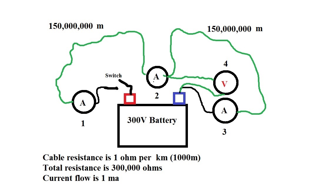

Simons puzzle reminded me of my days at college. At the instant the switch is closed the lecturer would say...... now calculate the current in L and this that and the other... and so on.
What do you guys think would be the outcome of this. Maybe its a silly question, maybe not. I'd be interested to hear your thoughts even if my maths won't keep up 😀
The green wire is 300,000km in length. If we say (for arguments sake) that the "speed" of electricity in a copper wire conductor approaches the speed of light, then, by conventional thinking it would take one second for electricity to travel down the wire. In the diagram, the four meters are all near the observer who is located by the battery and switch. The 300,000km of wire goes its merry way looping back to the observer at the midpoint. Under steady state conditions a current of 1ma flows. Each ammeter would show 1ma with the voltmeter at midpoint showing 150 volts.
So... on closing the switch, what would each meter read. Say you took 10 readings each spaced 100ms apart. What would you see ?

Mooly: voltage instantaneous (with a single switch). Current, there and back time.
Hmm... me no understand 😀
So that means meter "4" (the voltmeter) would show 300 ? volts at the instant of switch on. Full voltage because no current is yet flowing. Wouldn't that mean its registered a "change" in an event (throwing the switch) quicker than the speed of light.
I really don't get it.
After 0.5 second, what would meter 4 show ?
and what would meter 1,2 and 3 record ?
What am I missing 🙂
Since you only have one switch, the potential difference exists before you close it (assuming the setup was there more than a few seconds in advance!). It takes a second before the far end "realizes" that the switch is closed, then another second before the current reaches the switch end. There's probably a complication because of loop area, but I'm ignoring that for the sake of simplicity.
