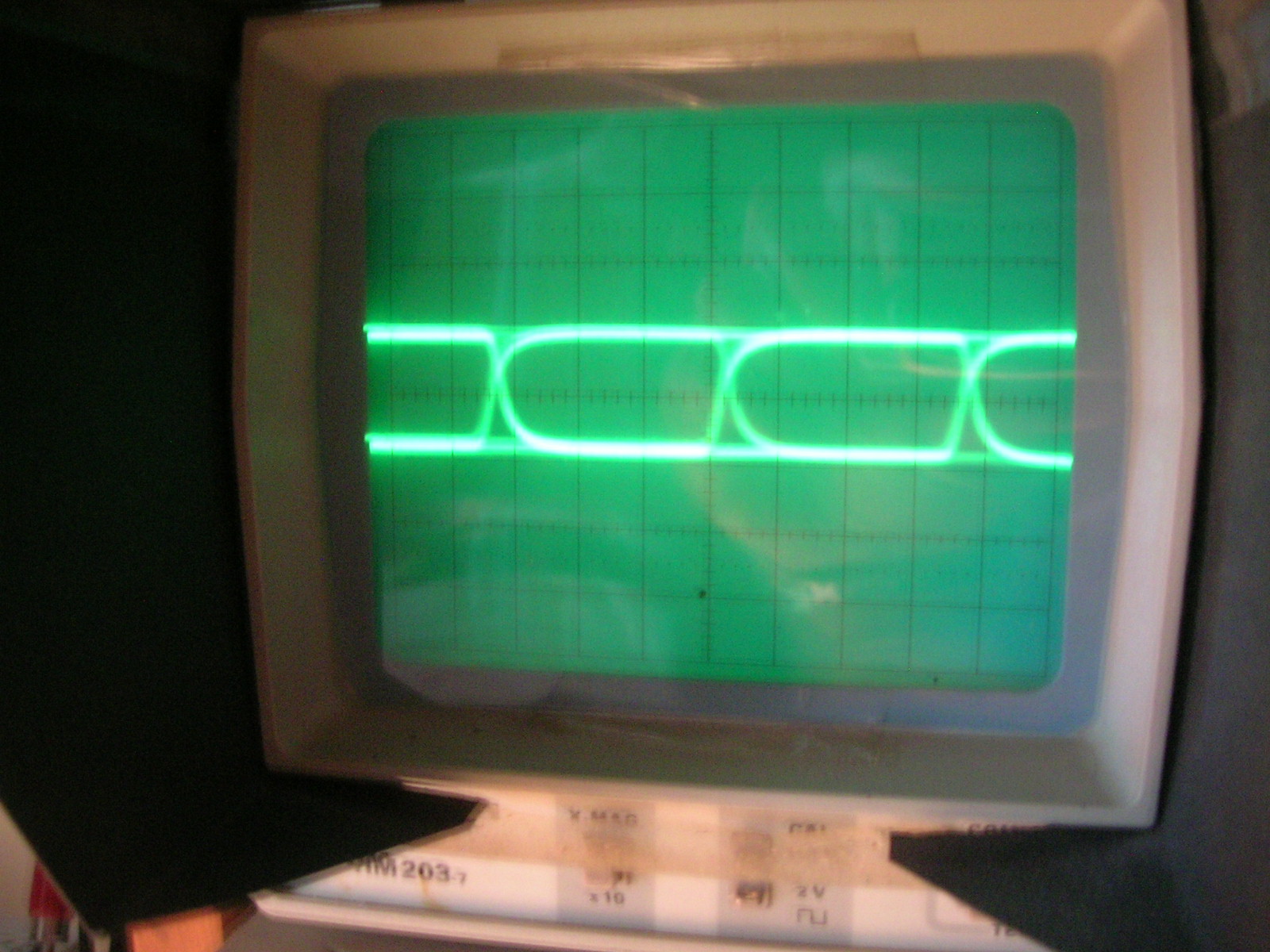

Hi Demian
What do you mean down to earth? Something more accessible than a TEK DSA8300?
Yes. GHz DSOs are not allowed to enter in my dreams. With my 20Mhz analog scope I can see the SPDIF eye pattern a bit hazy and that’s it.
There are many possible tools.
I wish that there is one up to ~ $200 🙂
And more, what do you want to know? In a sense looking at I2S signals to determine performance is like looking at the torque on a driveshaft to get 0-60 times. Its possible but very indirect.
Ha ha. Correct.
The components in my recent set-up are I2S interconnected. There are many things that I may can do better and this is what I want to look at.
…but what you want to know is on the analog output.
You may be right.
Yesterday I found this splendid paper written by the late Julian Dunn
http://www.electron.frba.utn.edu.ar/~jcecconi/Bibliografia/13%20-%20Medicion%20de%20Amplificadores/Documentos/AudioPrecision_AN5_DigitalAudioMeasurement.pdf
That’s a good start for me. Some of the tests are implementable with what I have (the scope, signal generator, soundcard).
