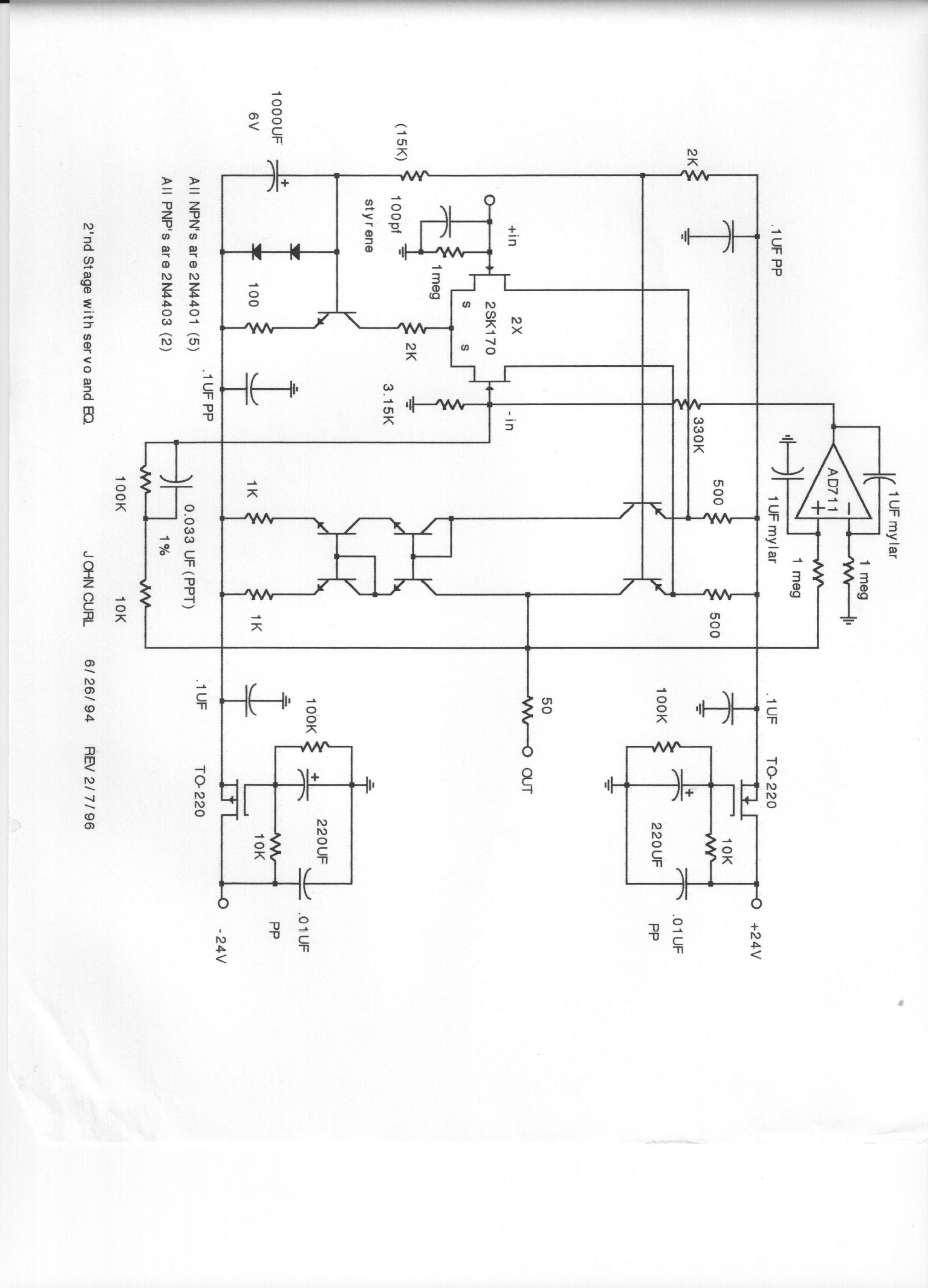

Now what about the alternative, of using all N channel parts?
That's OK too.

Personally, I would still choose an N channel pair (don't tell me that you can't find one) and then use complementary bipolar devices for the following stages. Did it for a decade, myself.

Here is an example of an ALTERNATE topology that doesn't have pchannel jfets, that is akin to what Scott Wurcer used for his AD797.
