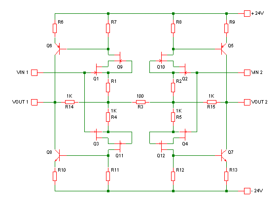

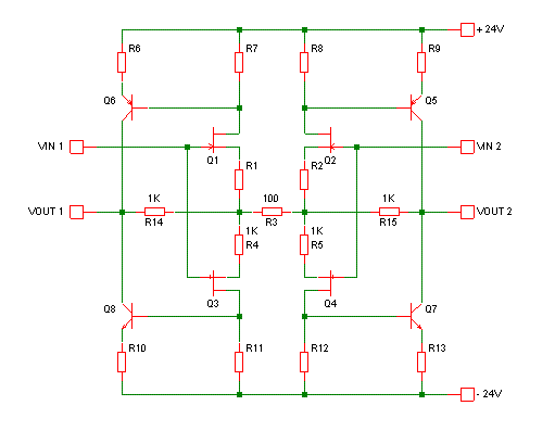

Here's a "bare bones" version of the circuit. The closed loop gain is set by R3, R14 and R15.
Vout1 = Vin1*(r14+R3)/R3 - Vin2*R14/R3
Vout2 = Vin2*(r15+R3)/R3 - Vin1*R15/R3
So with the values given:
Vout1 = 11*Vin1 - 10*Vin2
Vout2 = 11*Vin2 - 10*Vin1
Making sense now?

You mean on the input JFETs, something like this?local cascodes
I'd expect lower input capacitance, but possible stability problems. Haven't a clue about the effects on open loop gain and linearity.😕 Anybody else can shed some light?
Wonderful, Godfrey! By the way, what schematic drawing program are you using? I like it, as mine is too complex.
You have SHOWN why there is a difference in the two outputs, WHEN only a single ended drive is used.
The Csanky bootstrapped cascodes in a circuit do have a negative input impedance at high frequencies, but I've found this to be usually easy to compensate with some lumped C at the gate to common. However the reduction in input capacitance modulation with voltage swing is very advantageous for distortion reduction at high frequencies.

I have done some simulations with the upper half circuit which may be worth "publishing", but I think the gist of circuit operation is emerging. Remember that this is a relatively high feedback design, despite some of the inputs being low impedance open-loop. However it is fast enough that distortion is not much changed at 10kHz compared to 1kHz, and this is without cascoding. More at 11.

Thanks. I suspected something like that, but hadn't thought it all the way through.The Csanky bootstrapped cascodes in a circuit do have a negative input impedance at high frequencies, but I've found this to be usually easy to compensate with some lumped C at the gate to common.
Walt Jung did the historical research about Csanky and corresponded with him. A lot of material was uncovered after I discovered that the base current recovery topology most still attribute to Baxandall and Shallow was in fact invented by Frank Boxall, who passed away recently.Thanks. I suspected something like that, but hadn't thought it all the way through.
All of these circuits with such techniques are susceptible to the mechanism to some extent. In this case it is modified by the closed loop configuration a good deal. Remember of course (as I'm sure you know, but mentioning this for other readers who may not) that the added FET needs a higher pinchoff voltage than the input device to work well.
The added advantage of the Csanky circuit is to much reduce the signal-induced self heating of the input devices with voltage swing. When the overall circuit is driven single ended there is no longer means of inducing tracking dissipation shifts with signal.
Demian I think remarked, a while back in here, that the devil is in the details of getting this topology and related ones to do multiple duties: all combinations of single-ended/balanced inputs/outputs. And in particular the availability of a polarity reversal for those who hear the Wood Effect (no relation btw) requires that the gains be made the same. The higher the closed-loop gains are, the smaller the relative disparity between output magnitudes, but it would still be appreciable for the values shown.

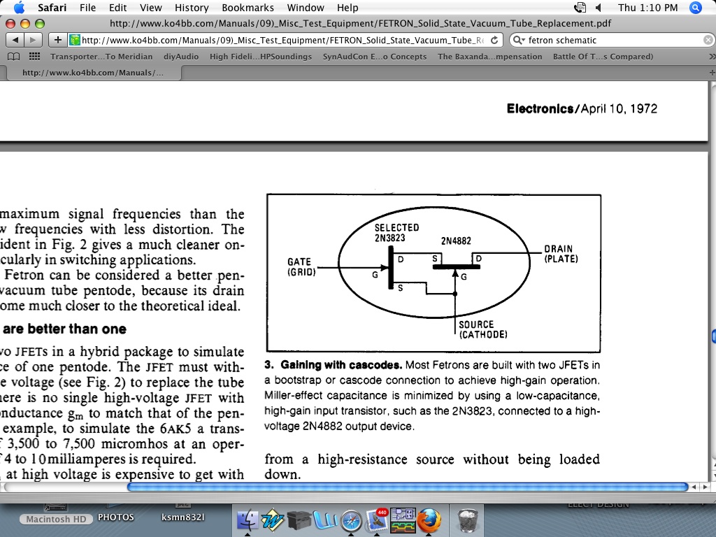

A real concern is the Gm of the respective devices in the self cascode. I tend to prefer to use normal cascodes or folded cascodes rather than the self-cascode. I think it is best to use a LOW Gm cascode part and a HIGH Gm part for the input part. This is subtle territory however, and I have not made extensive measurements of the difference.
The advantage of the 'normal' cascode is that you can increase the voltage across the input device, thereby lowering and linearizing the feedback capacitance across the input fet.
From my understanding, this 'self cascode' or as you call the Csanky cascode was first used as the FETRON, tube replacement jfet cascode (a very high voltage jfet was used as the cascode) fore replacement of the input tube for VTVM's back in the late 60's. I once made the same basic design for the GD back in 1973, to experiment with open loop subjective performance. They still preferred tubes, however. '-)
