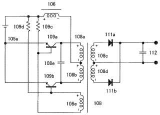

Fidelix Serenity Power Suppy its in Japanese
US7272019
To provide a switching power supply apparatus which can achieve the followings simultaneously in high levels: the voltage waveform capable of reducing switching noise to the least is in a sine-waveform; capable of providing an output of stable voltage without a control, and a simple response; and capable of corresponding to instantaneous peak current without having saturation of the core.
It relates to an improvement of a resonance-type Royer converter with less switching noise as a base, which is directed to be used for audio equipment. A second inductor is inserted to the primary side inductor between a rectifier circuit and a smoothing means, which is coupled to the primary-side inductor in a same magnetic circuit in a direction of canceling a DC magnetic flux.; Moreover, timing of the next cycle is determined by applying a center tap voltage of a transformer to a synchronous signal input terminal of a control IC. Thereby, a self-excited oscillating action is actually stabled. With this, high demands for use in audios can be satisfied simultaneously.
US7272019

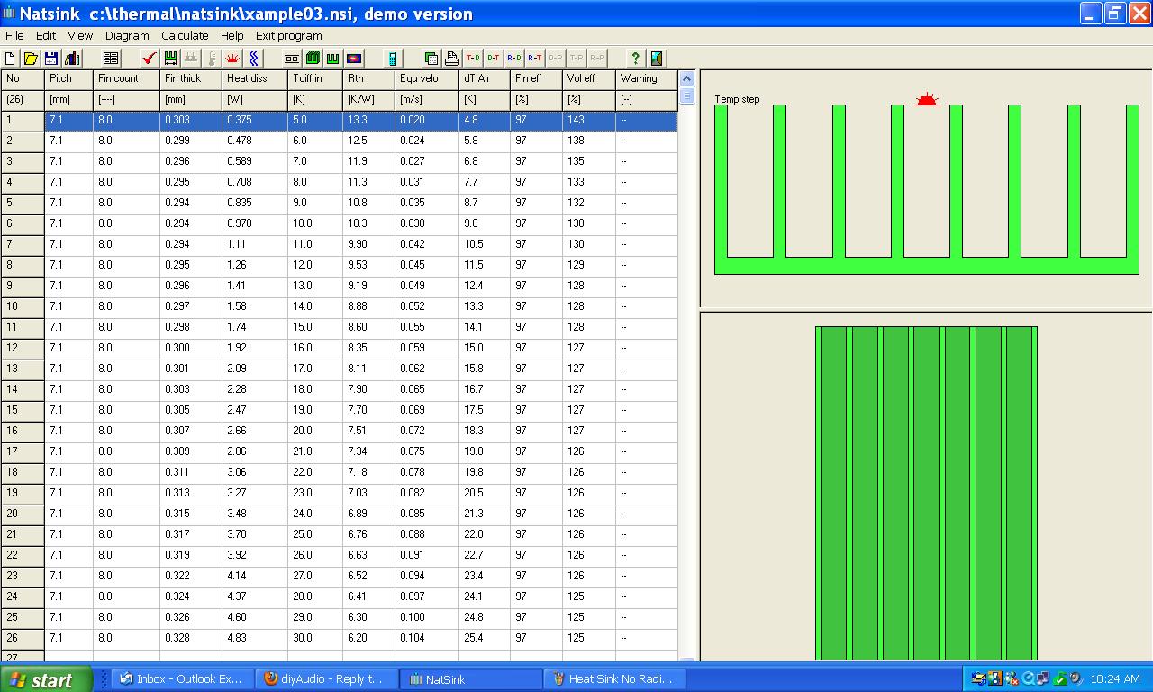

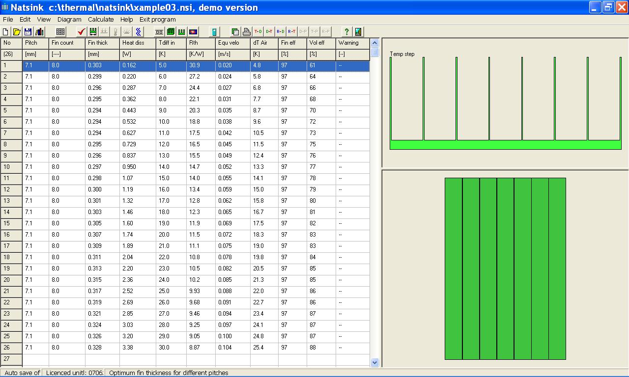

Now for fun I ran the heatsink demo program for the same example with and without radiation. Results are attached.

If the program uses radiation from interior verticle surfaces it is wrong. Did you ever use one of those aluminized mylar emergency blankets, think image source of you and mirror (at infra-red).

I think I confundicated youins. The data was for typical aluminum heatsinks, that is what the program does. I was showing even on a typical heatsink at normal temperatures radiation is an important part of the cooling.

Question authority. I'm saying if the thick/thin fins in the figure is turning on/turning off of radiant cooling it is wrong (and maybe they have made a mistake). The faces facing each other do not radiate away from the heat sink.

I really don't want use the argument, the simulations proves otherwise. However it is an accurate program. So the issue becomes how much heat from radiation does the little bit of air between the fins absorb? Or does the program only look at the radiation from the base and not the fins? I don't know what the mechanism is. But the program does work and almost all commercial heatsinks do get turned black.

I can't read the results.Now for fun I ran the heatsink demo program for the same example with and without radiation. Results are attached.
How does the program determine which radiation escapes and which is re-absorbed?
Agreed.If the program uses radiation from interior verticle surfaces it is wrong.
You showed only what the program did. I can't tell if it is accurate.Scott,
Ah, covers...you hadn't specified commercial.In commercial buildings it would be dry steam (Well above 212.)
Again, agreed.Question authority. I'm saying if the thick/thin fins in the figure is turning on/turning off of radiant cooling it is wrong (and maybe they have made a mistake). The faces facing each other do not radiate away from the heat sink.
NONE.So the issue becomes how much heat from radiation does the little bit of air between the fins absorb?
The radiation of the heatsink must be modelled as a 4 sided box. There are ONLY 4 equiv. surfaces emitting. The bottom of the base, the top of the base, the right fin right surface, and the left fin left surface. That's it.
If you keep the same overall size and change the number of fins, and the result changes, the program is wrong.
That is a direct result of anodizing's emissivity compared to bare aluminum. Notice the difference was rather large..I know from hooking up resistors to heatsinks there is a large difference before the aluminum is anodized and after, but I haven't recorded the numbers.
