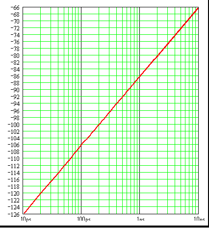

DIY way.. Vertical axis is relative level of unwanted "artifacts" in Dunn (J-test) spectra..

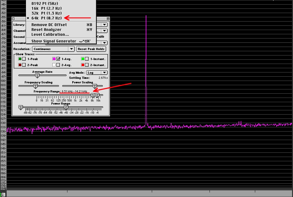

That spectragram that 1audio showed is meaningless! What about reducing the frequency span for a starters? i.e. zooming in on the center frequency..
For comparision - I just fed 9978 Hz sine to the analog input of an oldish "plain vanilla" Digidesign sound card residing in this same computer I'm typing this text on. The card itself is nothing fancy - 74HCU04 oscillator with off the shelf 48MHz crystal, residing in "harsh" enviroment and fed from the switched PSU.
Details on the settings are seen in the picture. I made the span as small as possible and activated 64 Bit analysis (see how "deep down" the analyzer can "look", if fed with the appropriate source + sufficiently low noise floor).
Do we see any sidebands? None! Nada! Zilch! It didn't matter in my case whether I used Hanning. Hamming, Triangular or Rectangular window.
What I am trying to say with all this - one has to have very low noise floor and/or very jittery clock feeding the A to D converter chip to see any sidebands by testing it with the signal fed to its input. If you see any that means the A to D converter is no good.

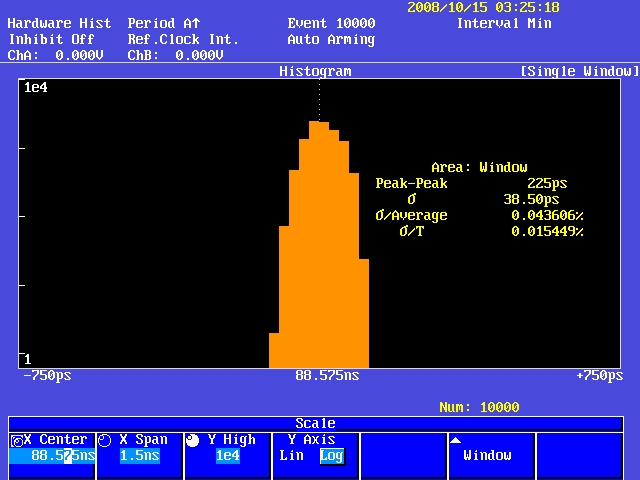

I'm affraid, it takes the specialized equipment ($$) to do any serious jitter measurements. I have a 43MS/s 25ps resolution analyzer here and even that is sometimes not "good enough" (right picture, for illustration only).

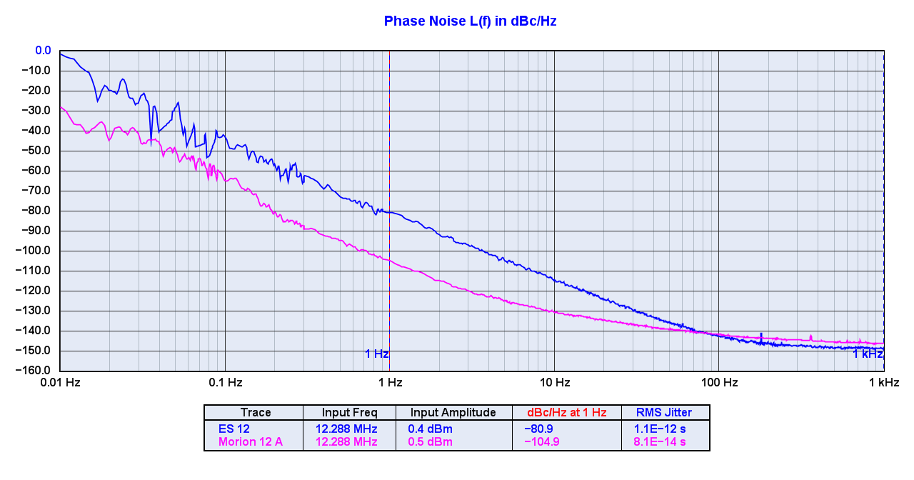

I got another denizen of this loony bin to solve my jitter issue. But where did you learn the trick of using an FM detector? :) (I need to have real numbers to present rather than I tweak it a bit.)
ES
Someone here mentioned it and I took the bait. It turns out to be more involved than it might seem. I posted my incomplete notes here on using a tuner: http://www.diyaudio.com/forums/blogs/1audio/983-fm-tuner-jitter-analysis.html
What kind of numbers did you get for jitter?

First, the point was to see if the ADC was free enough of artifacts to see problems with the signal from the 48 KHz word clock. It is. And the system can show problems (see the Apogee plot I posted).
Your not looking in the right place using the analyzer you mentioned. You are looking at cycle to cycle jitter and won't see the audio frequency variations. Your measurement of a 9978 Hz signal did not indicate what the source is. If its a loopback no jitter will be visible. I checked several very high performance sources that I did not post and things like power supply modulations show just fine. Its the same process used by Stereophile which has several benefits. First its the audio output that matters. Second Stereophile has published a number of measurements to compare to.
Being able to look at the spectrum of a word clock directly is useful if only to see if there are real problems. Also, while having a clean word clock is important it doesn't tell you anything about the pll used in the DAC/ADC and what that adds. Eventually you must look at the audio outputs.
I have made really high resolution measurements and they do show issues occasionally. The QA400 is limited to 65K point resolution. My Praxis setup which is more costly (around $1200) can make up to 16 million point fft. It takes a while and you don't see much more. I have access to much more exotic equipment (e.g.: DSA8300 Sampling Oscilloscope | Tektronix ) but it still won't show these audio frequency problems and is a monumental PITA to use. I stopped looking at clock jitter directly since it was becoming fruitless.
BV thanks for the chart.

Piece of cake. But what is the physical quantity that this methodology show?
