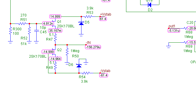

For my intended use ...... Also DC offset has to be low, because there are no caps coupling the four pots used.
Check the schematics thoroughly, this buffer has almost no DC output offset .... like 150 microvolts or so. Depends on JFET matching.
Mooly, I am not trying give you a specific design for YOUR needs, this schematic is over 20 years old and is intended for another company. It works fairly well down to 2K ohms or so, but 10K ohms and above is preferred.
It is just an ALTERNATE APPROACH to using an OP AMP for a buffer. It replaced the AD712 in one design with great success. It is not an 'idiot proof' design like an op amp is. It does have limited current drive, will NOT drive headphones, can be biased wrong and have lots of 2'nd harmonic, much more than one would want. Only high current versions of the 2SK170 or the 2SK389, etc will work optimally.

Pavel I guess this is with perfect matched devices, perfect matched supply zeners...?
jan
First, it is the simulation. But, the real thing has very low DC output offset as well, if JFETs are well matched. Zeners are not that critical. The circuit published does not show decoupling.
