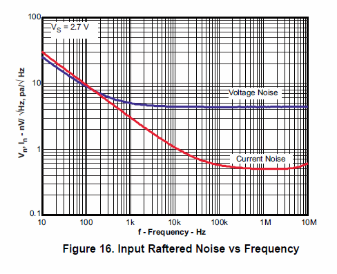

Regardless low supply voltage, OPA836 has VERY high noise and VERY low quiescent current. No good for audio, would be source of troubles only.
