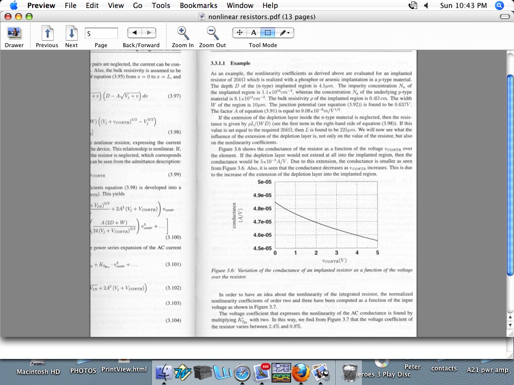

How about that IC resistor non-linearity, Scott? You know the ones you use in most IC's. Please say something useful.
Which resistors? N diffused, P diffused, N well, P well, polysilicon, thin metal film? Or you mean the CMOS implementation for linearised floating resistors, with a value depending only on the β of a matched set of nMOS transistors?
Please be specific.

To refresh Scott's memory:
We don't use those things in any critical place. Any gain network would use thin film resistors and the linearity pushes a few ppm or so (if that), and yes I said that days ago and jcx and I both produced examples.

Which raises the issue of do the resistors used in monolithic circuits behave badly enough to reach a problem level. Since I haven't measured such resistors and what their actual contribution to total distortion would be when placed in the actual circuit topology, the answer is I don't know.

Where they are not critical, or they produce no (or little) distortion, because they do not deal with variable voltages following signals, or their non linearity can cancel the active devices ones, or they are part of the open loop, so their (low) distortions are canceled, like the transistors non-linearities, hundred times higher, by the feedback.Of course the solution is don't use lousy resistors.
