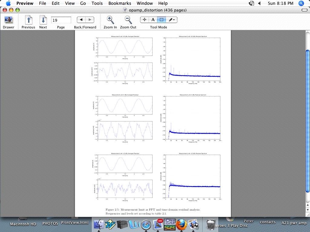

This is an example of distortion measurement done by Groner. Does everybody know what they are looking at? SY might perhaps explain. '-)

My conjecture is it spreads it out to so many frequencies so as to appear like noise. FFTs don't have a great time with showing up noise.
If a repetitive signal generates random output this could happen. However generating random outputs would render most electronic systems useless for anything but generating noise. Repetitive signals will generate predictable artifacts unless there is some really unidentifiable mechanism at play that only affects music like patterns.
FFT's using available audio ADC's can easily see noise and artifacts lower than -140 dB FS. The chances of a transducer even reacting to such a small signal seems far fetched. Even electrostatic transducers have enough internal friction as to probably not move with such a small signal.
I would go back to my earlier question about time frame for measurements. Its far more likely that resistor values change during musically significant periods due to to heating than harmonics and noises below -100 dB FS are audible. And I even think the resistor tempco's may be too small to be significant but its something I have not seen tested. (Read the ADI article on resistors to better understand what I'm talking about.)
Yes but only that low in the narrow bandwidth of an FFT bin which is typically these days 3Hz or lower. Spotting a relatively broadband noise floor shift of a dB or so isn't at all easy on an FFT. Or at least, as far as I'm aware it isn't - I could have missed out on some new techniques 😛
@PMA - its 'and FFT is poorly understood' 😀 Brings to mind James Keiser's saying.
Try using the "search this thread" option if you're interested. That's all I'd do anyway- I don't keep post numbers memorized. The discussion spanned perhaps a dozen posts. Even better, google "groner opamps" and read his paper yourself- it's not hard to understand what his test setup was, how he measured, and what the measurements mean.
