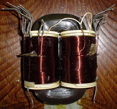

Well, you could flip it around if you're on 120vac mains with a dual 120vac primaries. In either event, you'd be in 'violation' of Menno Vanderveen's US patent # 6087822. This is used in the Torus conditioners from Bryston.
It worked quite well on the primaries of an overspecified r-core powering a dac.
Thanks for that patent. It requires bifilar windings! (Both coils are wound at the same time so the interwinding capacitance is higher, but the magnetic field is so close to the same.
Wrong! This is a magnetic canceling circuit. "....so that high frequency harmonic distortion is magnetically canceled in the core of the transformer..." Makes for a clean transformer design.
But what I put up has been done for thousands of years or more. Not patentable. Anyone can and has used it.
It is shown to be used as a concept leading to others.... summing out of phase signals passing into and thru a transformer to cancel the unwanted.
Thx-RNMarsh

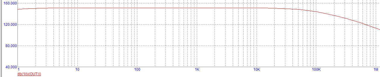

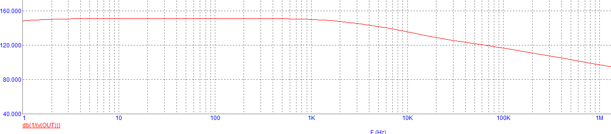

These are the psrr graphs of shunt regulator with different compensation.
Which one will sound better?
