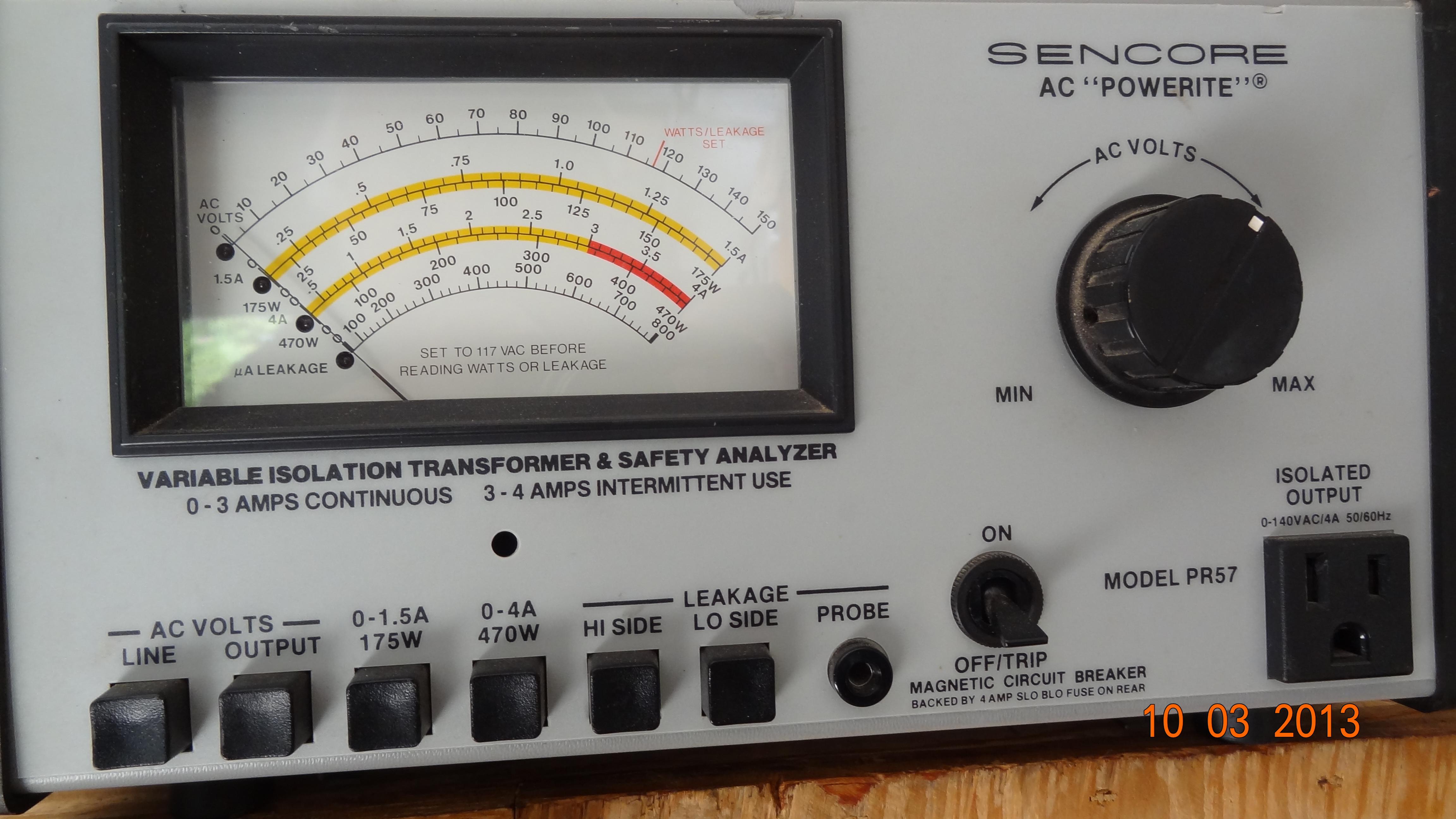

JC tried to point out why his products have to cost what they do.... I would like to add on to that in another way.... UL safety and parts costs related to it.
In anything I do for others, i insist, or I dont work for them, that parts which touch ac line volatges must be a UL approved part.... every inch of it. I dont want to get sued, later. The cords, switches, fuses, fuse holders, capacitors, inductors, pcb trace size and materials and spacings -- everything pertaining to safe construction for sale to the public. Well, wouldnt you guess that each part that has VDE, UL et al stamped on them cost several times more than the same value without such testing and approved part? Several times as much. then it has to be constructed with similar care and standards applied. Then the whole package/finished product has to get approved ... more $$$ and many distroyed products later, you get to sell it to the public. I am not saying any brand is or isnt -- just that a good, proper and safe design cost a lot more.... and buyer beware! of what you get for your $. Specify it also be UL approved or dont use the transformer or cap etc.
Thx-RNMarsh
One of the test equip used for low power products -- test junky that i am -- attached;
