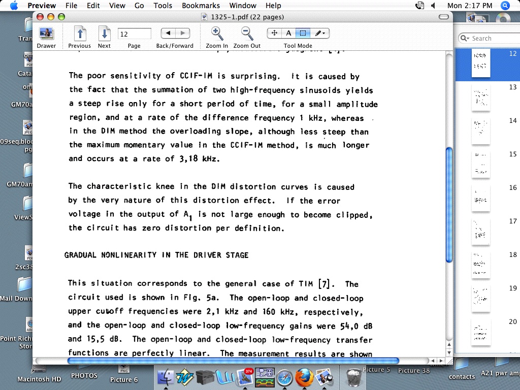

Don't you realize what a MIXAGE between several instruments can do, and what kind of speed can out of a DAC between two samples ?The microphones are just not that fast.
We may have very very high slew rate, and still note very low twin-tone 19+20kHz distortion. Thinks are not THAT simple.
Not for long enough to average significantly. Otala tested this signal (and others) back in the middle '70's.
That's a scary signal there 🙂Esperado, I measured this stuff for YEARS! So far as I know, I found the fastest possible signals from mistracking an Ortofon cartridge. Look at Ortofon graph on p.264.
Bcarso, it is an almost 'impossible' signal, if you want both high amplitude and accurate amplification.
