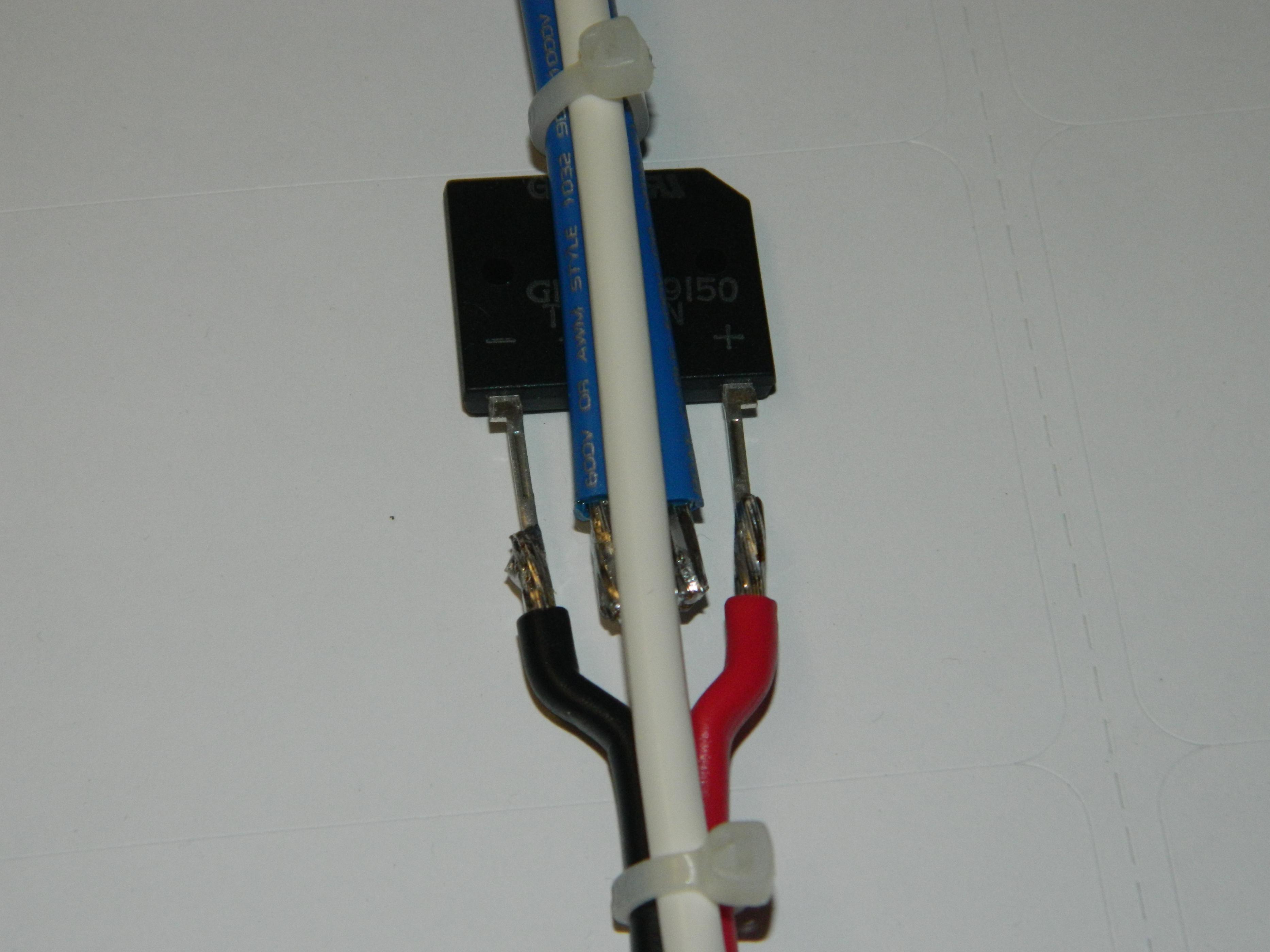

jneutron,
Given that your solution was so elegantly done what of a standard situation where the center tap wire is not long enough to reach all the way to the capacitors and the bridge has screw terminals? Would you not still be able to braid the wires and extent the center tap wire, and what effect would the screw terminals cause?
Question does this also happen with multi secondary windings ? Will a duel secondary with a derived center point have the same effect and how much . Yes it not a direct answer to the question but is an option if the transformer is not already in hand.
The effect I speak of is independent of the transformer configuration. It is sometimes necessary to worry about the wiring inductances and the impact of changing current on a conductor.
For a dual secondary, I'd twist the wires in pairs so there is no wiring coupling between. What happens in the core stays in the core, RN spoke on that.

jneutron,
I tailored the description to the xfmr RN posted, where the wires were soldered to the terminals.
The concept is workable even if you have screw terminals. The principle is to keep all three secondary wires intimate with the ground, and both rails after the bridge the same. Keep all loops as small as possible. Extending the center wire via splice or terminal is not a big deal to the concept.
With discrete wires, the best you can hope for is an inductance reduction of about one order of magnitude. From 2 to 5 uH down to 200 to 500 nH.
My solution with copper foils and dielectric sheets was to get the inductance so low, and the capacitance so high, that I was able to eliminate capacitive bypasses at the chip amp. The inductance back to the supply caps was in the 10 nH range.

Here's a demo of what I meant. The white is CT, the blue wires are AC feed, the red is pos, black is neg. Note: I do not recommend simply tacking wires like that, but I had a GBU8K on my desk, so used it. Also, it's not necessary to keep this linear geometry, that was just for my convienience. White is #12, others are #14, so braiding or even bending wasn't possible while keeping the bridge leads straight..
Note the AC (ground) simply passes through the neighborhood. It goes directly to supply cap center. The ties keep the wire spacing minimal.
Note also that the triad grouping minimizes rail to rail inductance as well.

jneutron, thanks so much for the explanation, that is very clean. so to summarize for the somewhat disabled, this arrangement is primarily to keep the loop area for parasitic inductive effects as small as possible, 'ground' impedance as low as possible, while also adding some small amount of capacitive decoupling for HF (or this is only when foils are used?)
Nice summary. The wires don't add a lot of capacitance though, so the foils were better for that.
Within a chassis, any supply rail changing currents will produce magnetic fields which can induce voltages. By making sure all the major currents are held intimately together, the external fields will be made smaller. My foil thingy almost eliminates external fields because of how close the rails are (5 thousandths of an inch), combined with the very long reluctance path around the foil.
My foil construct started at the xfmr, to the bridge, then caps, then to the chipamp, then to the output binding post. I reduced the width of the foil from the chipamp to the binding posts however, kept that at 10 nH per foot. (an alternative would be to simply increase the dielectric spacing of the output run to 10 or 20 thousandths of an inch and keep 2 inch widths.)
I also floated the output neg binding post, all speaker current returned to the supply directly over the chipamp.
A foil construct from xfmr to output is not as practical when using discretes however. The best one could do there is have the output devices in a line so that all supply and ground lines run the distance from the caps to the outputs.
jn
